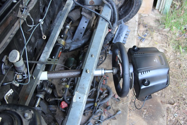

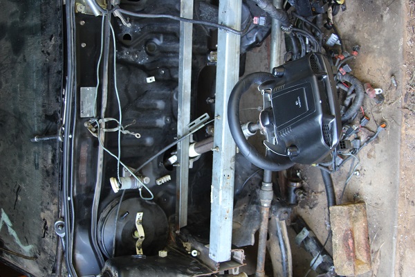

1. Put a sleeve over the driveshafts to keep them off the ground and allowing them to free spin.
2. Built an extension for the steering column, positioned a couple of bearings on it. Added a couple of cross-members and bolted the bearings down using power steering rack brackets (see below). The idea is to mount this shaft to a logitech G27 steering wheel,but instead of using the steering wheel on the unit, will be using the FTO steering wheel. Still need tobuild a custombracket and weld that to the end of the shaft. This bracket will be the same as the back of the logitech steering wheel.
3. Got the feel right on the brake by using the booster with a spring behind it. and got the clutch feel right by adding the master cylinder and re-routing the pipe back into the cylinder with a couple of kinks in it with pliers.
So still have to work out how to work the Logitech pedals from the FTO pedals, but well on the way.

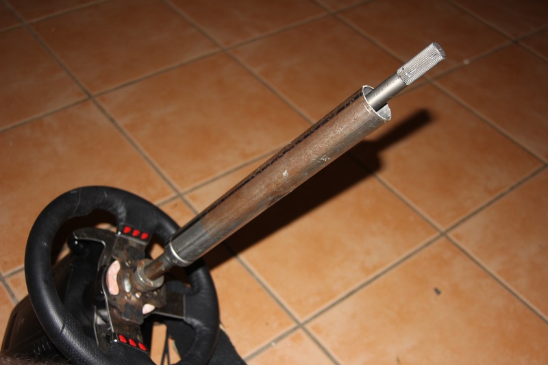

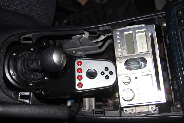

    Got a logitech G27 steering wheel setup to modify to fit into the simulator. It arrives yesterday. Think ive worked out how to attach the logitech to the extended steering column. Will be using the logitech gearstick in place of the normal gear stick at this stage. Will be dismantling the pedal set and either mount inplace of the pedals or under the FTO manual pedal set. More pics soon.

          Got my logitech wheel in the post this week. Have now built an adapter on it that takes a steering column (reversed). The steering mechanism will consist of 2 FTO steering columns. the one attached to the wheel will feed into the bottom of the one on the car. Turning the wheel in the car will thel turn the logitech wheel.Should be able tofeel the force feedback through the steering column.

            Yep, had seen those. Adapters are expensive though. And this way, I havent had to modify the wheel. Just removed 3 bolts and replaced them with longer ones. May have to buy the adapter to allow it to work on xbox though.

              Here is the steering wheel fitted. Need to build a bracket to hold it inplace though:
              And have the gearstick sitting inplace. Still have to build a base to support it though:
