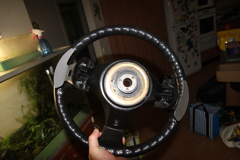

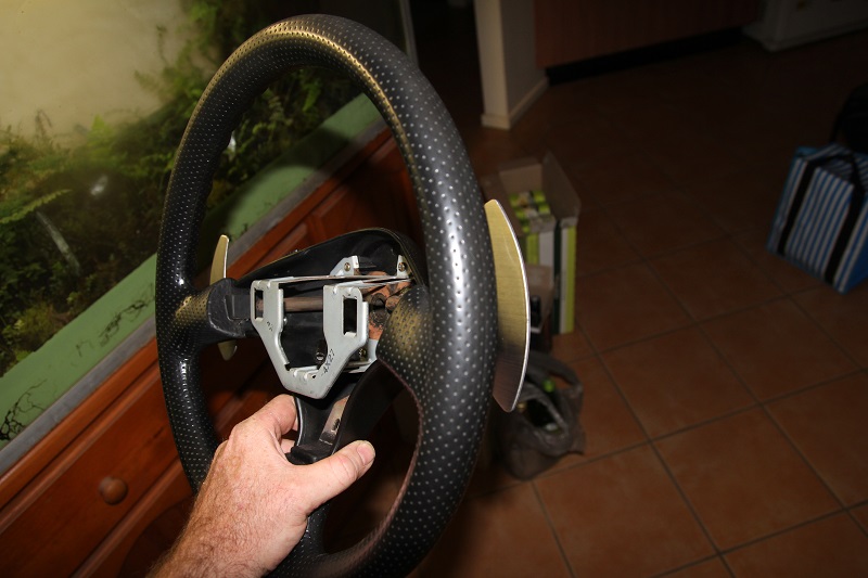

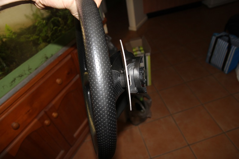

Added paddle shifters to a stock FTO wheel for the simulator. Interestingly, these would work on a real FTO as well:

Nice job on the paddles. Should show that to Rob or whoever it was who was trying to do it. I suppose it is just wired into where the gear stick generally effects the gear changes from in the console?

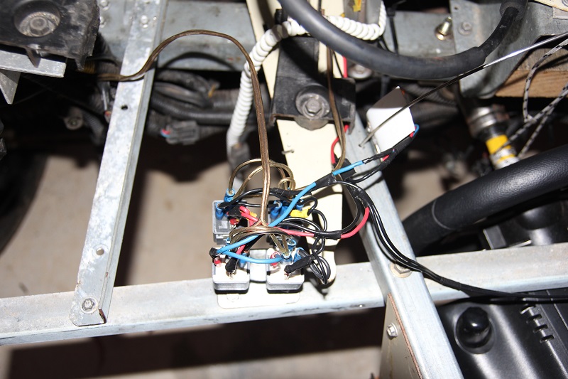

Actuators working but not adjusted. These pull down the strut towers when the steering wheel is turned. Have yet to test out how they feel, but hopefully will make a difference. Used 4 car relays to swap polarity of the actuators. Will need to put a microswitch on each side to stop the actuator pulling down too hard as ive already burnt one out and had to rewire it. Cant cope with the springs fully compressed. More Pics coming soon.

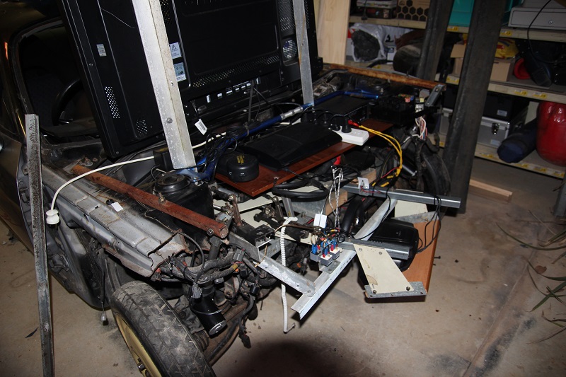

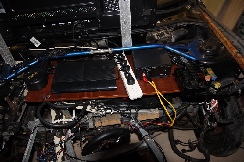

Most recent pics:
Re: Project Sim
Making nice use of that strutbrace lol.
View from cockpit with Tele on?

Re: Project Sim
Will take some and post up

- The electrics of the car are driven by a 20 amp regulated power supply. This is just hooked up to the positive and negative wires thatwould normally be connected to the battery.
- The electric actuators are connected to the regulated power supply. They are currently triggered when turning the steering wheel, but im not getting enough fine adjustment, so may have to change that. Im reversing the polarity of the actuators using 2 automotive 5 pin relays. Ive also had to add a circuit to stop the actuators when the pressure on the springs get to be too much as I burnt one of the actuators out from this issue and had to rewire.
