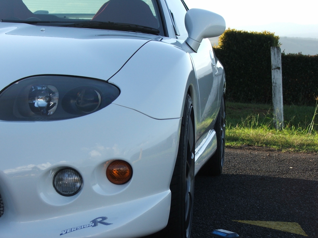

I have just put a set of work emotion wheels on my fto. I put 18x8.5 with a +25 off-set on the front and 18x8.5 with a +20 off-set on the rear. Running 225x35 tires on the front have no problems with scrubbing and rims sit flush with the car 8) (has to roll rear guards)

Gholdwayne wrote:
fto-007 wrote:I have just put a set of work emotion wheels on my fto. I put 18x8.5 with a +25 off-set on the front and 18x8.5 with a +20 off-set on the rear. Running 225x35 tires on the front have no problems with scrubbing and rims sit flush with the car 8) (has to roll rear guards)
I want to see pics of that!
could of fit 18x9 under it with the off-set but they didnt make the wheels in a 9 just 8.5 and 9.5 :(
