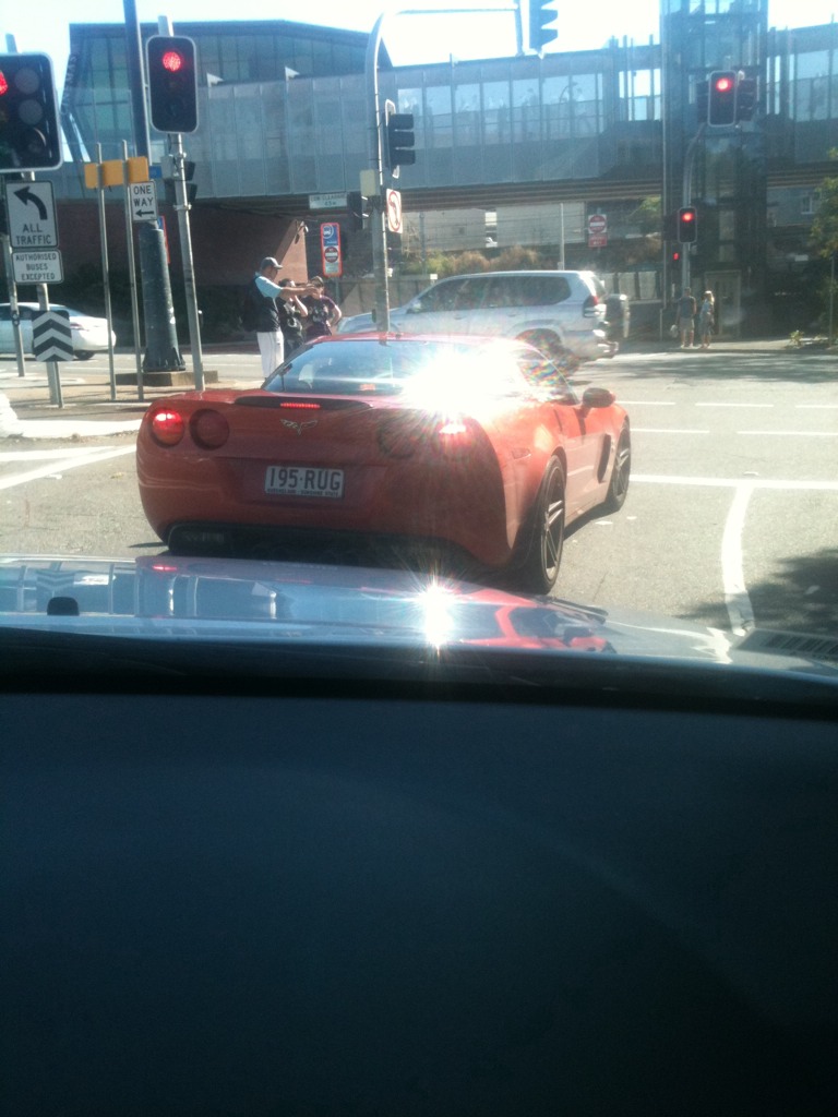

Re: Big brake kit
Ben, do you know what the rotor is they use with the UAS kit? ie what it's off?
Posts: 5518
Big brake kit
Off one of these
Posts: 23668
Re: Big brake kit
Shane001 wrote:Ben, do you know what the rotor is they use with the UAS kit? ie what it's off?
Nobody can tell me. Its closest relative is the C5 Corvette. We think its a custom made thing.
Its been to 3 suppliers & no one can match it up. I've got an appointment with the tech guy from DBA this afternoon @ their Silverwater office. He's my last resort.
UAS can get replacements, but their supplier is wanting them $386 a pop ex tax (thats UAS's buy price!) and they're not saying what they're off or if they're custom :roll:
