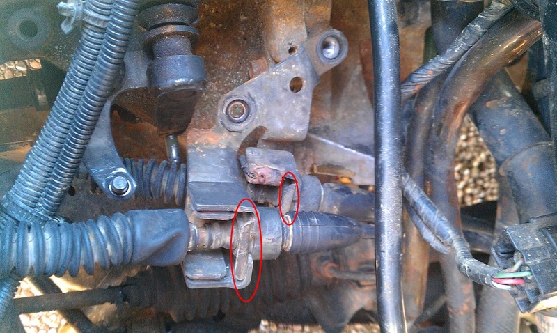

-__- or maybe I haven't explained myself properly... How the hell do you get the cables out of the old bracket and into the new one? like they don't just slide out?
Re: Need Help, anyone???
Pull the clip out, there is one on each cable.
Then slide the cable back toward the firewall, and the bracket toward the radiator.
The cables will then come out.
Edit: attached, pair of pliers pulls them out.
Bolt the fked bracket back to the gearbox (trust me, this is the only way you'll do it) then using multi grips, yanks off spring clips that go around the cable in the bracket. They have a flat steel section just above the cable, get a hold of it & yank as hard as you can. They're tight bastards.

Ohh I see and yeahh they are F*cking tight! Okay let's see how I go :S

IT AIN'T MOVING!!!! excuse my caps... but this is frustrating any tips besides pull as hard as you can?
It's similar to the one that holds the break fluid tubes in around the rotors, we had to remove them last weekend, just douse them in WD40/CRC etc, that what we had to do.
Yep, a bit of lube makes tight things move. :cheeky:
I found that if you can hammer in a tiny flat head in between the bracket and the clip (not too hard, just enough to get it in) and then twist the flat head slightly - just enough to separate the clip from the bracket - then try removing it again, it should be much easier.
And yes, as always a bit of lube like WD40 will help too.

Yeah I tried hammering a flat head in and it was still hard... Also now I think I need to put all this sh*t back together to drive down to Supercheap and pick me up some lube... -__-

Got the top one finally off! Now the bottom one, which looks even harder to get at... :?
