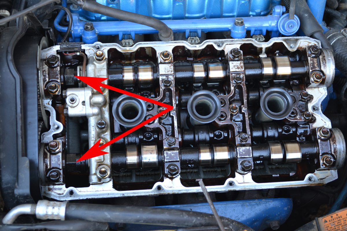

There is a special tool to hold the cam sprockets while you undo the nuts, but...
You can also...
Hold the camshafts with a spanner/adjustable wrench on the flat/hex shape just inside the engine, and use an impact gun (if available) or spanner to undo the nuts.
or
Take tha camshaft and sprockets out as a unit and hold the same mentioned part of the cam in a vice and undo the nuts.
You can also...
or

thanks heaps, ill see how it goes!PHIL069 wrote:There is a special tool to hold the cam sprockets while you undo the nuts, but...
You can also...
or

I agree, nice engine you have there ZFL45H1, it was the first pic I found to show what I needed to.
