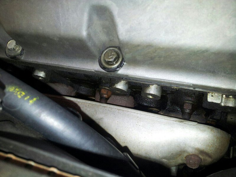

Alright I've just tightened the rocker gasket a few notches on my 94 gpx and I'm hoping it helps but incase it doesn't, does anyone else have any suggestions? I know the leak is coming from the top end.
Its been leaking for a while and the knob that owned this before me neglected it badly.

New gasket from amayama
Re: Oil leak problems
silverGPX wrote:New gasket from amayama
This^
About $30 delivered
Make sure to get o-rings for the tube seal (if applicable to the FTO, I am not sure)
Sparkplug seals

for one you have your bolts tightened too much as the bolt seals are squashed right down..
