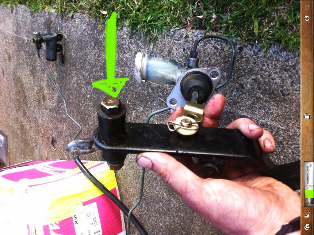

Having trouble understanding how to put in the clutch pedal.
I get the part about drilling the holes for the cylinder but where does the top of the pedal actually bolt on? There's no info on it or pictures is there some sort of a pedal bracket?

where does this go??

somewhere up here ???? How?
Re: Installing clutch pedal
That top bit still has to attach to something though ?silverGPX wrote:Ftos run a floating pedal system man

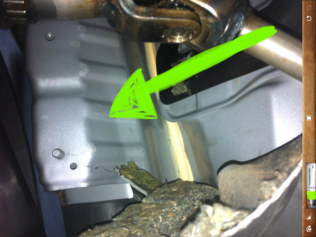

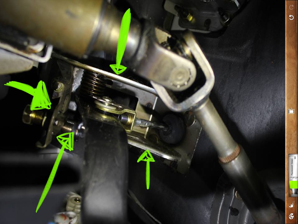

Hope this does the job, it's quite hard to fit a DSLR down there
thanks Braydon ! If u get a chance sometime and could get another pic from up further, near the colored wires. Would be great! This still helps abit. Cheers
Hope this helps, I can't get much better as the camera is too big
perfect.. Thanks for the effort
Now all I need to know is if this is one big single bracket and what does that bolt go into. Bennoz I know you would know this! please help me out when u find time mate ..
Can't believe this isn't in the guide that I fkn paid for wtf
- SchumieFan
- Posts: 5875
- Location: GPS signal lost
those bolts look like they dont belong there... isnt that where the springs are?
