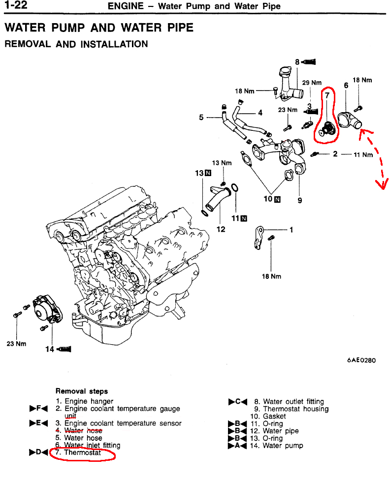

Re: Cooling System...
I have circled the thermostat for you.
The red arrow is where your bottom radiator hose goes to, just to make it easier for you to find.
