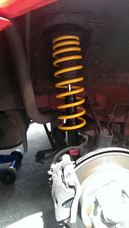

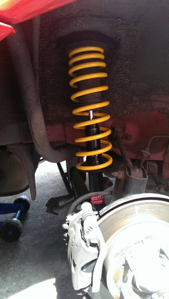

Alright. We tried on the rear shocks and springs and they seem to be ok. The mechanics concern was that the spring was moving when it was fitted onto the shock absorber. I asked for a second opinion at PEPS and they said it should be ok and it was. Rear is done, now starting on the front. Here's a pic
Re: URGENT Help RE: shocks and springs
How come your sway bar mount is off?

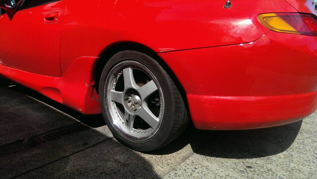

is it just me or do those wheels seem tiny?

The wheels are 17" I believe.

Wanted to ask now, when you guys changed the front shocks and springs if the plate on the shock that the spring sits on rubbed against your tyres? Because that's the issue I'm facing now. Need to source out new shocks as the spring plate on KYBs are 7mm too low. So many problems!
What profile is your tyre?
You must have fat tyres on the 17's ?
Some spacers will fix the problem.
What size tyres do you have on those 17 inch wheels. As longas the KYB's you have received are the part numbers quoted, there is nothing wrong with the shocks. the problem you are having will be due to something else you need to replace. The KYB's are the most common shock for the FTO. Half the members in the club are running them (including me). If you are getting rubbing, then they either havent been fitted correctly, or one of the other suspension components (or tyres if they are too big) needs replacing.

    I know my tyres are low profile. I'm running Contisport contact 5's I believe. The tread on them is almost gone I think. The mechanic said today that I have wide tyres.
    Sounds like your offset might be too high.

      notoriousTASH wrote:I know my tyres are low profile. I'm running Contisport contact 5's I believe. The tread on them is almost gone I think. The mechanic said today that I have wide tyres.
      get the 7 numbers off the sidewall of the tyre to determine how lowprofile and what wheel size you have.
      itll read like this > 235/45/r17

      I've got 17x7 sitting on 215/45. Clearance is fine. Just by looking at your wheels id say the tyre profile is too big or as dwayne said, your offset is not right.
