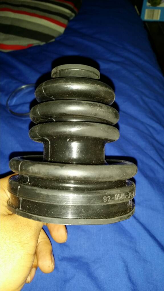

Re: I broke something....I think the Inner CV
So only way it won't fit is the length right? It has matching triangular grooves inside it as well.
Posts: 5518
It should look like this Image
Posts: 5518
Holy f**king camera quality Matt lol
Lol wtf never touching Apple crap :P
So you want to see if those grooves match the ones in the cup right?
Posts: 5518
There won't be grooves in the cup lol the shape just has to be the same
Urgh, you know what I mean :P those three triangular thingy in the boot should go in to the cup and fit perfectly. Like slot in. I'll clean the cup and just try fitting them in I guess.
