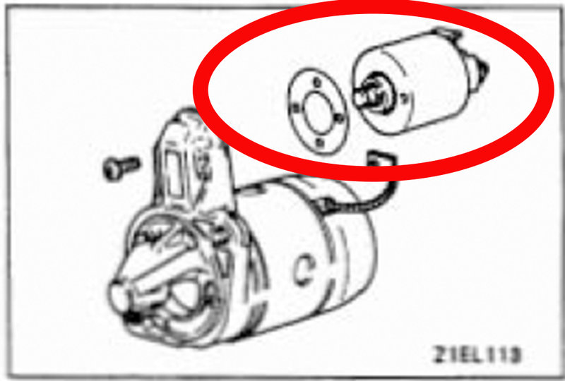

Pics...
This one shows the solonoid...

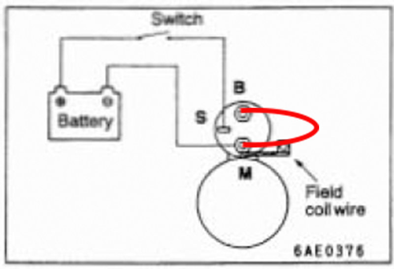

This one shows the two terminals on the back of the solonoid
Ignore the wiring in black, I have added some red wire to the pic, you need to do the red wire.
Re: I just want the thing to start to get it to an electrici
BTW, if you want to wire directly to the positive battery terminal with an inline switch, you will be wiring to terminal "M" in the bottom pic.
