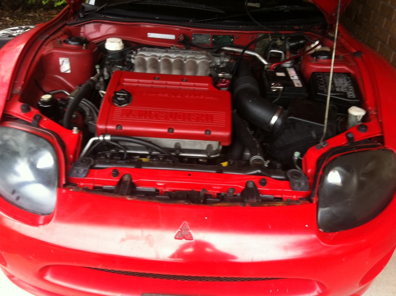

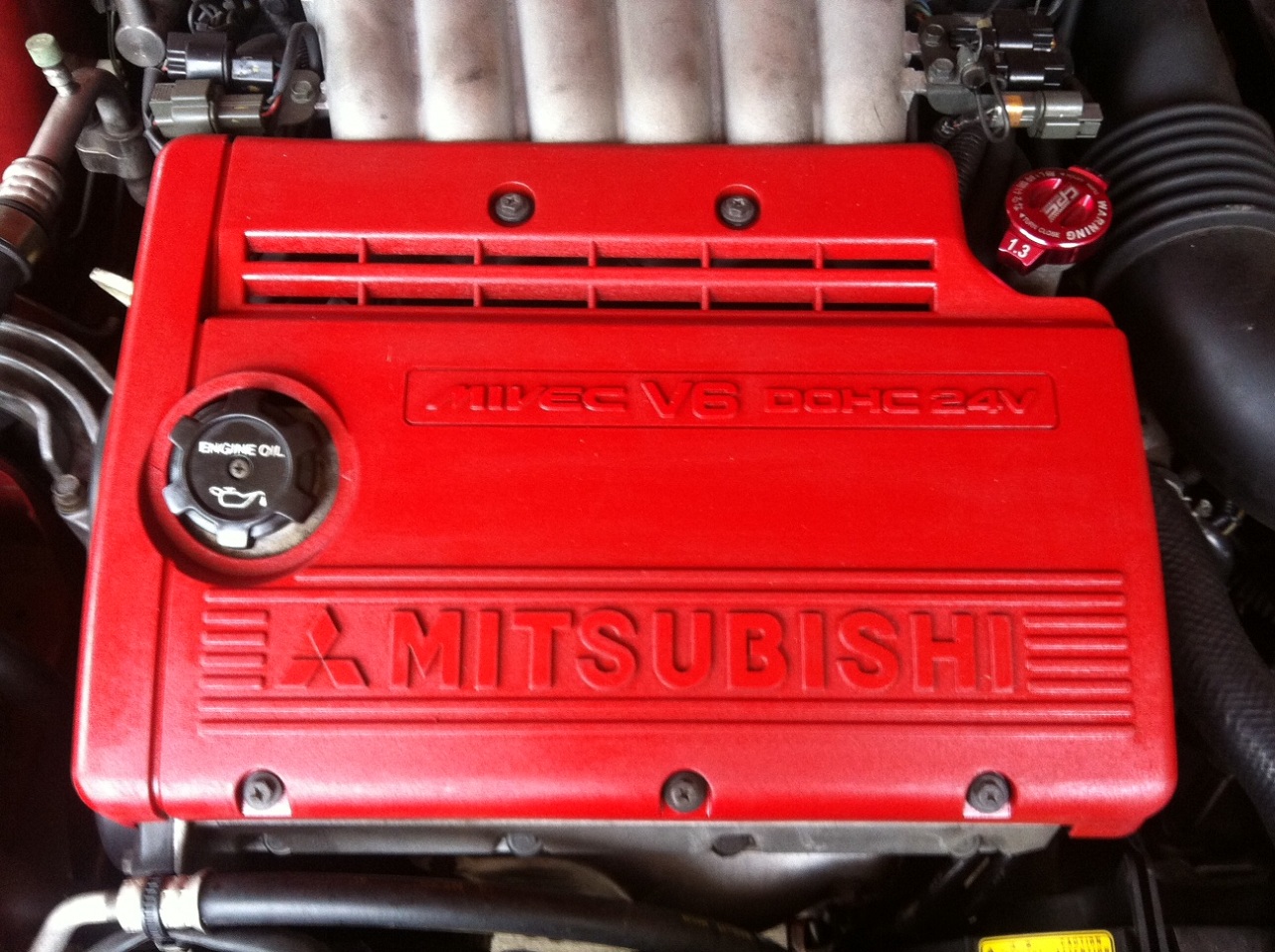

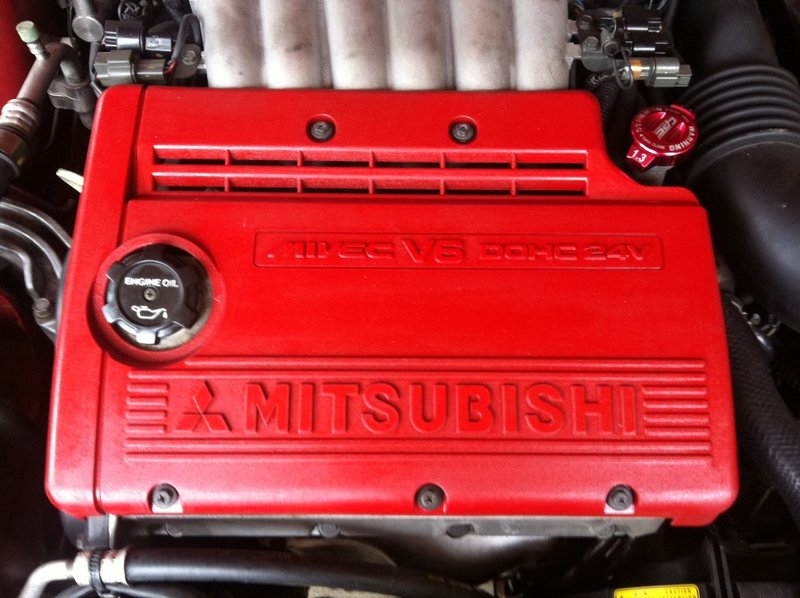

heres some photos :)
im the biggest noob when it comes to mechanical things, so i think i did pretty well! all by myself :) thanks aza for the DIY!
looks alright in person photo makes it look awesome haha was contemplating spraying the words.. but meh
:D
:D
photo makes it look so good imo
Re: How to paint your engine cover.
Looks good!
I still think you should paint the words white or something though :)
I think paint black.
Posts: 9087
If you want the letters black just get a sanding block and some high grit sand paper, then just rub back the red paint letting the black plastic show.
Then give it a hit with high temp clear coat, job done :D .

Technikhaus wrote:Looks good!
gonna leave it like that.. words will depend on what else i put in engine bay (colour scheme) haha took me a lot of effort (resisting lazyness) to do that XD
