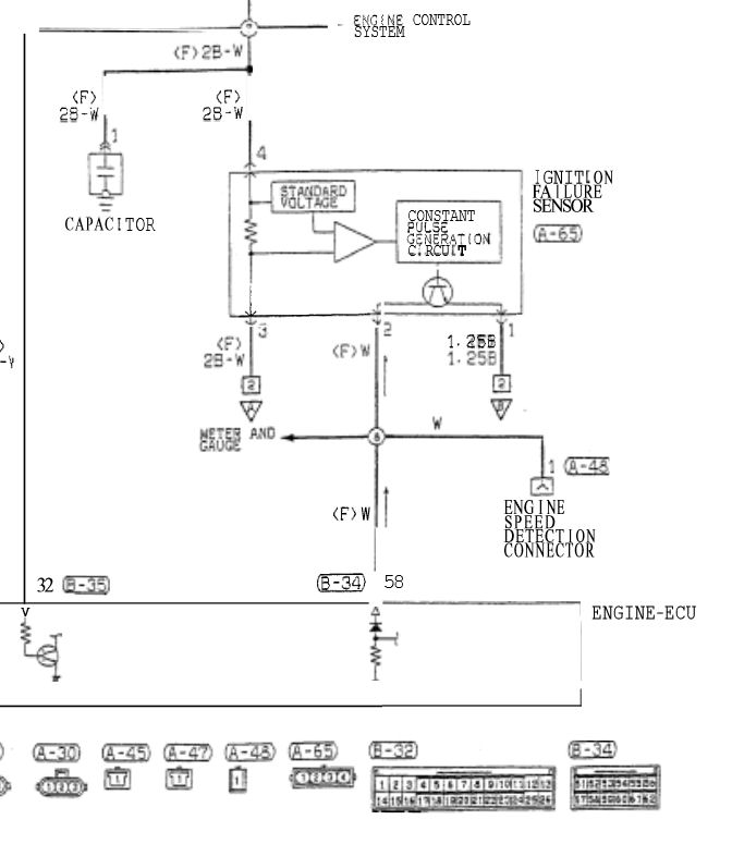

no idea where it goes back. Downloaded the FTO circuit diagram manuals and found the connector which originally connected to the Igntion Falure sensor but seems to have been bypassed, I assume it is no longer needed with the new ECU but must have to be Bypassed to keep the original ECU from chucking a fit???
The question is. Which two pins on the 4 pin Ignition Failure Sensor would they have bridged?? Any suggestions would be most helpful.
Attached is the circuit diagram of the IFS and its pinout.

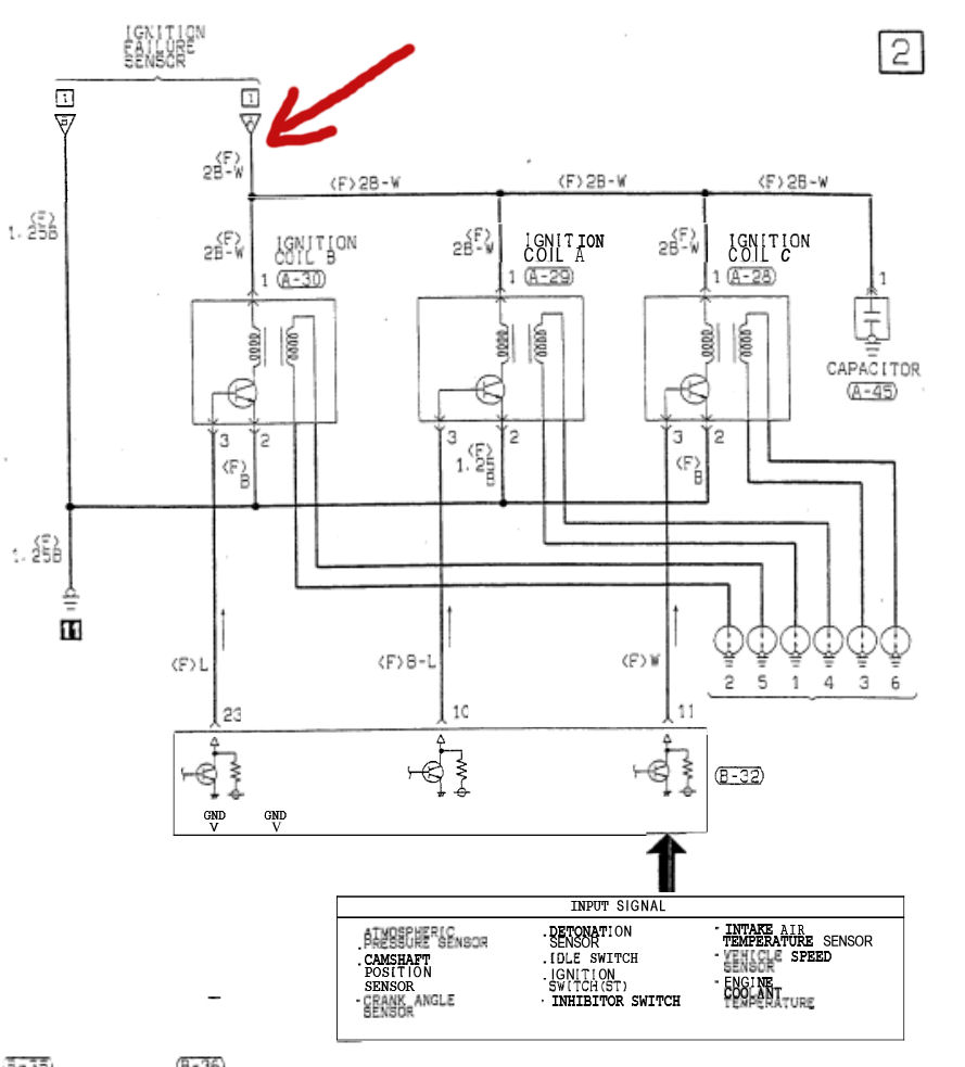

Have been trying to understand how the IFS works, and how it connects to be able to monitor the Coils. In the second pic I have put an arrow pointing to a wire, AM I right in thinking this must be supplying a Positive Voltage to the coils whenever the ignition is ON ??

They didnt bridge the Ingnition Failure Sensor, They Bridge the CONNECTOR that originally went to the IFS. (the connector was no longer plugged into the IFS, instead was a wire bridging two of the four pins in the plug)

I would say if they have bridged 2 wires to keep the ECU happy...
Pin 1 = Earth
Pin 2 = ECU
Pin 3 = Coils (Earth)
Pin 4 = Positive
I believe that the IFS would get power from PIN 4 and when the coils are active (pulsing on/off) it gets earth from pin 3.
When it gets a closed circuit (Pin 4 + 3) from recieving earth from the coils it then closes the circuit inbetween pins 1 + 2.
When 1 + 2 are closed the ECU gets a closed circiut and is reading that ignition is present.
Now i reckon the circuit from ECU to ground via pin 1 + 2 would be a pulsing circuit (on/off/on/off/on etc) as the coils fire, the rate of this pulse allows the engine speed to be detected and metered.
In saying that if you bridge 1 + 2 the ECU will get a constant closed circuit.
If you bridge 2 + 3 the ECU will get a pulsing circuit from the coils, but I'm unsure if bypassing the Constant pulse generation circuit within the IFS is a good thing.
The "CPGC" would keep the pulsing and voltage at a constant speed varying beat.
That's all I have, good luck

Turns out the old ecu doesnt need the IFS Pulses anymore, and they had jumpered pin 3 ( + to the coils) and pin 4 ( + from the ignition key). I wonder if pin 3 supplies +voltage to the coils in all fto engines. From the circuit diagram it seems that it does. Originally thought the Ignition Failure Sensor monitored the coils and informed the ECU that they are ok or not, but it seems from what I can work out from the circuit diagram all it does is inform (by sending pulses) the ECU that there is + voltage from the ignition switch. Do you guys agree?
