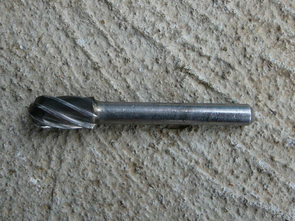

Nice. Did you have fun grinding out the manifold?
- Shane001
- Posts: 2730
Re: Making Progress...
Piece of piss, I'll post up my secret weapon laterBennoz wrote:Nice. Did you have fun grinding out the manifold?
This is what you need, one of these little bad boys

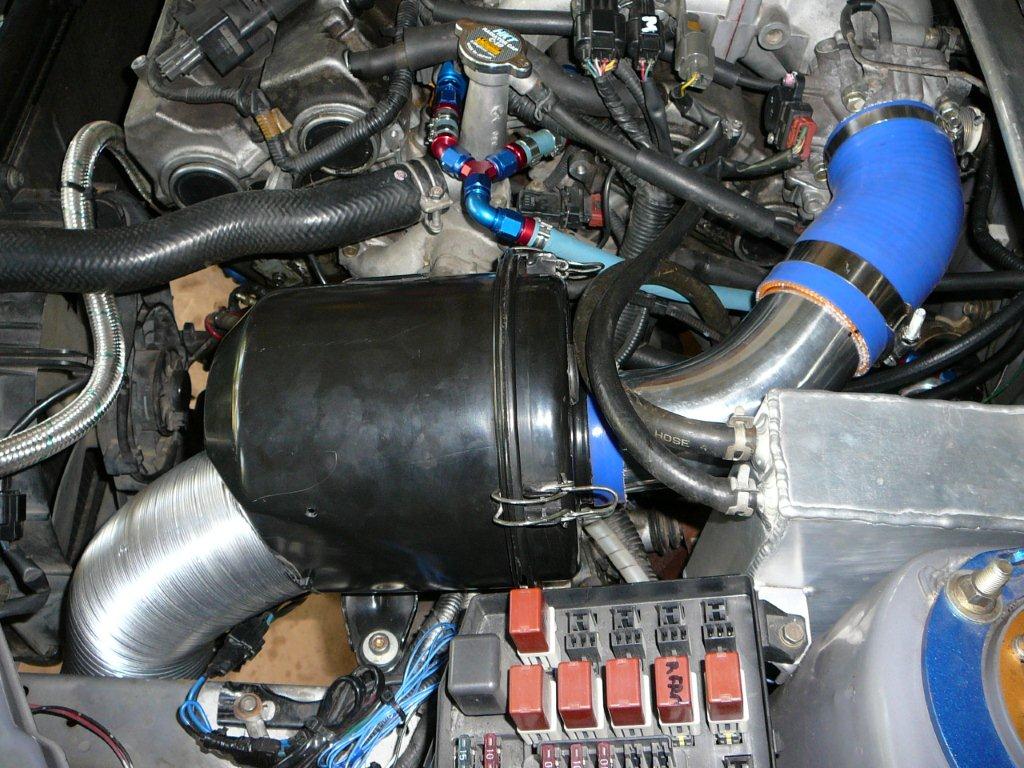

Won't be going to Wakefield tomorrow, still working on the new intake.
Update: air intake complete. still a little bit of tidying up to do but functionally it's as good as it will be.

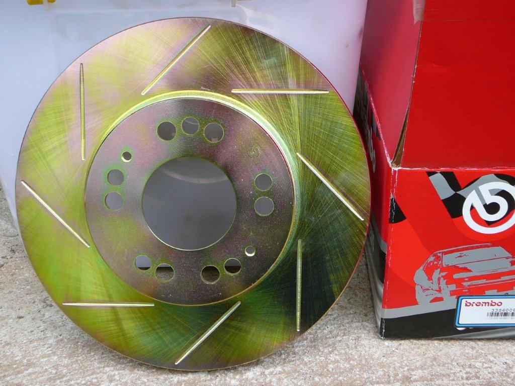

New brake rotors. Brembo goodness all the way from the US of A

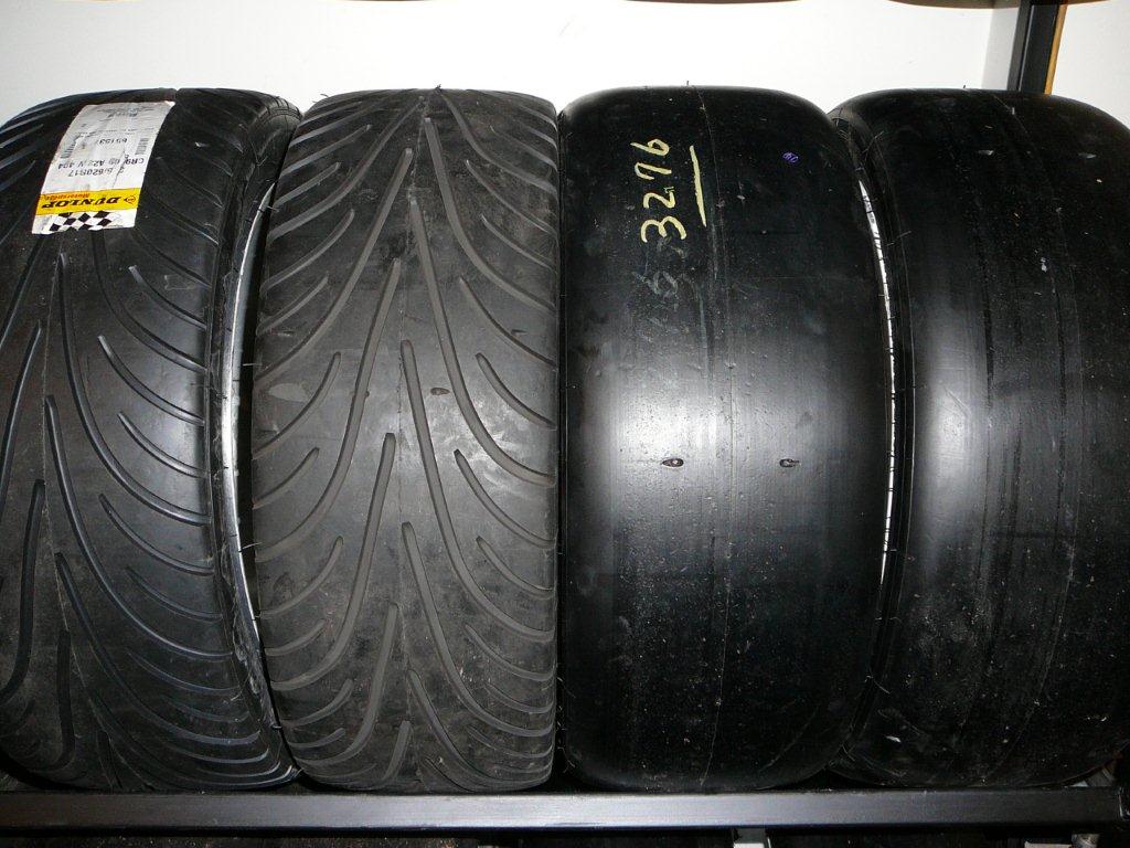

Let's hope these f**kers don't crack like the DBA4000's do, 2 years in a row 2x new sets of tyres, a set of racing wets just in case it rains, and my first ever brand new set of slicks! Sooo looking forward to putting these on for the first time at Bathurst And my order from Camskill on Friday evening arrived this morning!
