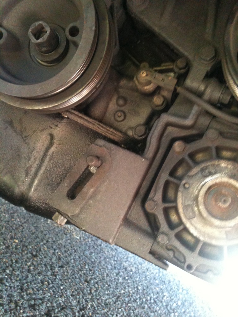

Hey guys, so after having my car for just 2 weeks, its now garage bound because the bottom Idler pulley pretty much fell off as i was driving last night, i was wondering if anyone has had to replace one of these before and is it a big job?
Also it looks like ill need a new one since it got all scratched to sh*t when it came off, and was wondering does anyone have one? or how much will it cost to pick one up.
If its unclear as to which pulley came off, when looking from the top of the engine bay, its the very bottom one, or on completefto.com, (37-100)
Cheers

Piece of piss mate. 14mm nut on the side of it, 14mm adjuster nut under it & you're done.
You can buy them new from places like http://www.amayama.com/, works out at about $115 landed, or wait for someone like dstocks who has a 2nd hand unit.

Cheers buddy . Ill upload a photo of my FTO aswell

Thats pretty much what mine looks like, lol.Sahin wrote:I beat your pulley fall off record
It got skittled on the road, so its no good

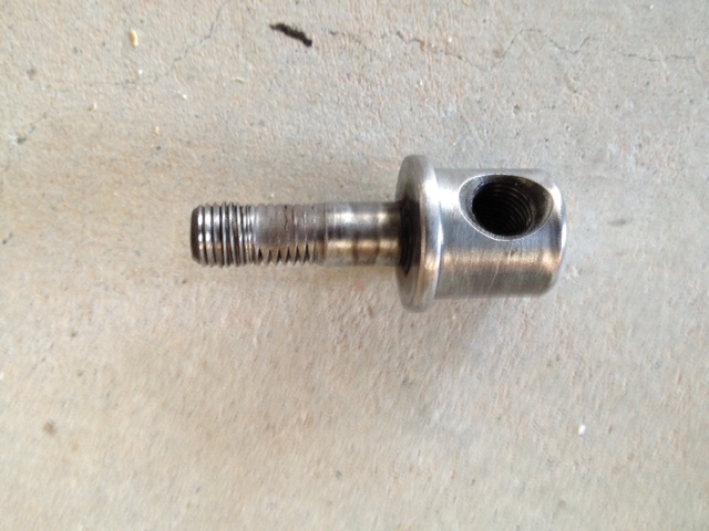

when I got home and had a closer look at the Power steering / AC pulley adjuster I noticed that the bolt is worn and there is no thread left on part of the bolt.
This may be the cause of all my problems.
Would anyone happen to have one or know where i can get one

- dstocks
- National Vice President
- Posts: 9529
- Location: Utopia
Re: Power steering/Air con Pulley
Quite probably me actually. I can check tomorrow.
