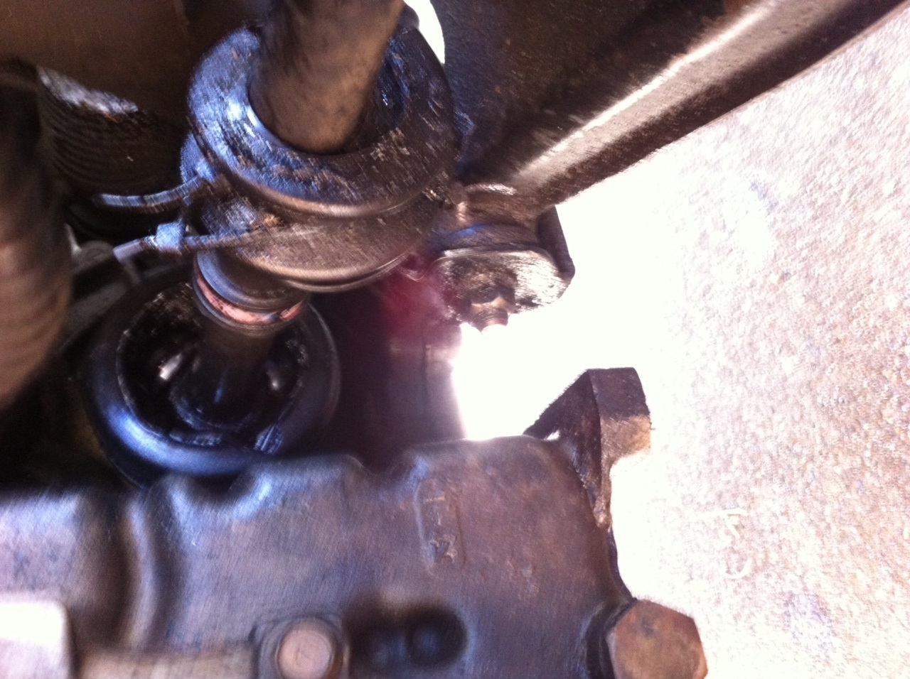

I found this today aswell.. Looks as though it has been like this for a while, grease flicked everywhere.
I have new cv joints for when the car needs it, but wasn't going to replace the whole joint just for the boot, so I cut the old sh*t one off and cut through the new one so that I could just slip it on then a few wire cable ties and abit more grease and is as good as new.
So yeah should be able to get a universal boot pretty cheap

Lol you're not meant to cu the. Boots to fit them or there's no use fitting new ones lol

thisSahin wrote:Lol you're not meant to cu the. Boots to fit them or there's no use fitting new ones lol
The grease ain't gonna stay in there by wrapping cable ties around a cut boot
And OP, refer my previous post, the reason you couldn't get the drop link in was the other side was still connected higher.
And if you look at those shocks from the bottom, ie stand them up side by side, the holes look like they probably would go close to lining up anyway, they're not that far out to worry about.
And OP, re the cv boot and the shaft, do yourself a favor and don't drive it until you replace this, could be very costly otherwise. If the shaft has come out all the little bearings inside could be all over the place, the shaft could completely fail.
It's on fine for now. Might not last but definitely better for now.
Staying in fine, was a good fitShane001 wrote: The grease ain't gonna stay in there by wrapping cable ties around a cut boot .

Theres a couple of ways to do it but the way I do it is get a cone shaped piece of plastic and grease that so you can slip the boot over it and the actual joint and straight onto the shaft...

Tbh I probably should of just put in the new cv joint, cos now I have one without a boot haha

I wouldn't recommend this but I was running around in my civic for a whole year without cv boots on the drivers side shaft loldestinationtoby wrote:Sahin wrote:Theres a couple of ways to do it but the way I do it is get a cone shaped piece of plastic and grease that so you can slip the boot over it and the actual joint and straight onto the shaft...

So is the outer shaft supposed to be able to freely move in and out of the joint?(When the rotor is unattached from the strut brace). The shaft I am talking about is the one outlined in red. Its too dark now to take a picture of my own car, but it's the same thing. Need to know if I only need to replace the boot or if there is some sort of pin that is supposed to hold it in that I need to get replaced. Also to clarify, is this the CV joint? Or is that the joint closer to the rotor, or are they both CV joints? The drivers side shaft didnt fall out when the rotor was swivelling around itself. Though the boot was intact so this could have been what was keeping it attached.

Shouldn't come out of the joint that easily...
But yeah there are 2 cv joints on each side!
Inner and outer as you could see... Both connect to a cv shaft.

I'll jack that bitch up again tomorrow and get a better look. and take pictures that hopefully somebody can diagnose, if not here, another mechanic. Because it is obviously unsafe to drive down to a mechanic

The joint without the boot on will slip right out. The boot holds the joint in place.
