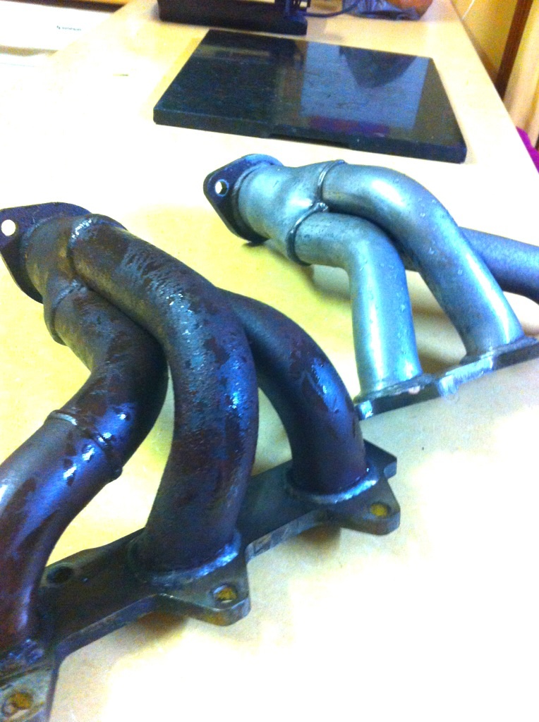

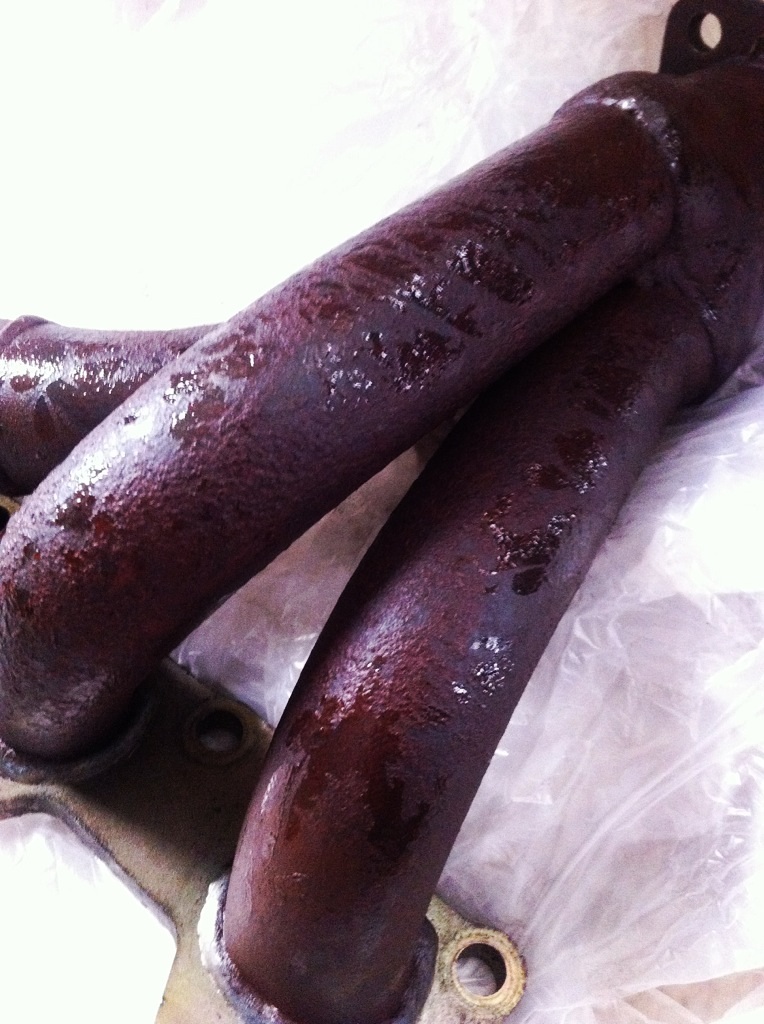

Testing out the vinegar rust removal technique. And wow the progress so far.
Have had that extractor (last photo) in for 50 minutes only, and about %70 of the rust has gone! And it wasn't just light surface rust either.
To hell with paying for sand blasting.. Can't wait to see finished result.

Surprisingly good result.

Wow 8O. Wouldnt have guessed.
    Re: Holy vinegar
    lol, we do this all the time at work... dont use supermarket vinegar though, its weak as fk

    Actually the combination of salt and vinegar works a lot quicker apparently
    Re: Holy vinegar
    SchumieFan wrote:lol, we do this all the time at work... dont use supermarket vinegar though, its weak as fk
    80c a litre, cheapest white vinegar I could find. Bought all that was on the shelf at Coles .. Works excellent

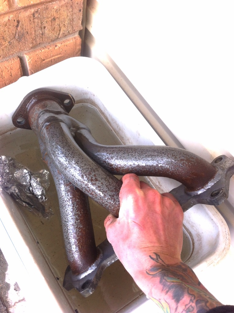

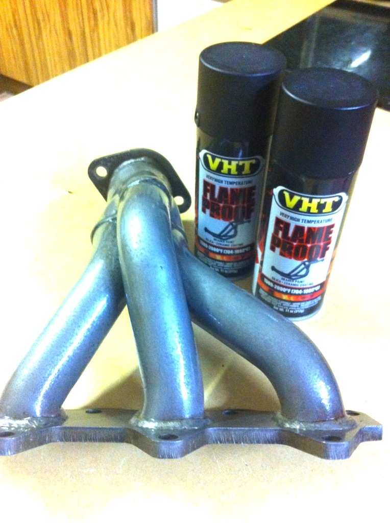

    It's been a few hours, figured ill just scrub whatever rust is left, off with some steel wool.
    Will be ready for paint in no time.
    Re: Holy vinegar

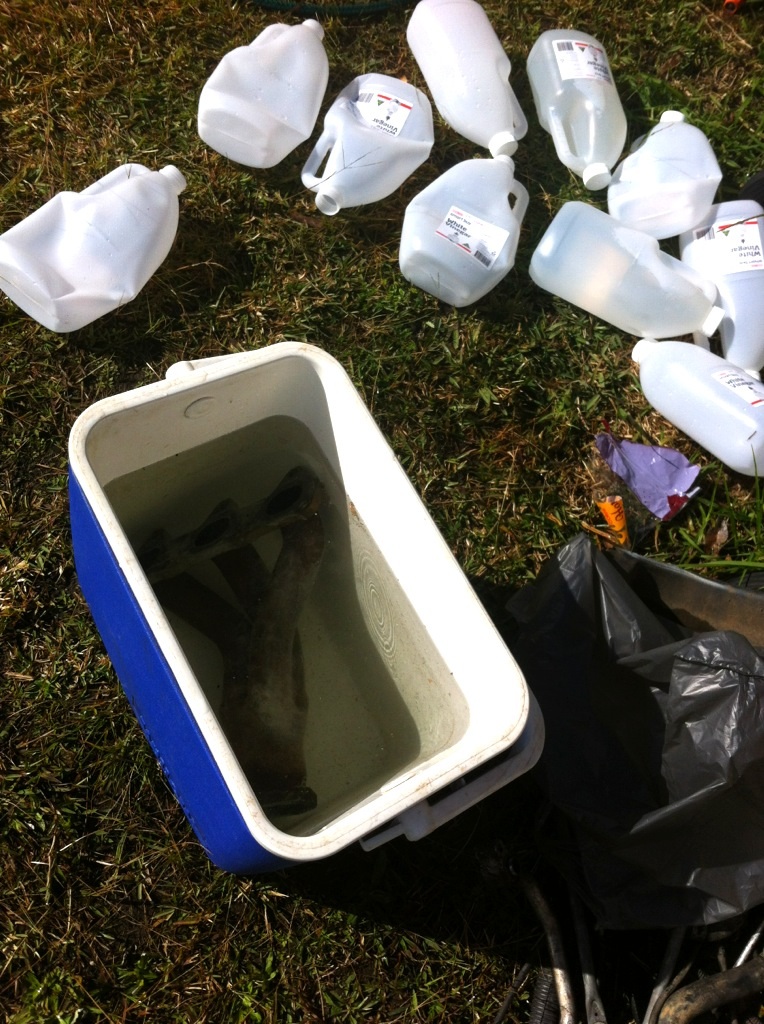

    Don't know how I'm going to go about submerging the whole Y pipe though...
    Re: Holy vinegar
    Might need moaar vinegar :twisted:

    destinationtoby wrote:Don't know how I'm going to go about submerging the whole Y pipe though...
    Get ya long pipe out in the bath tub!
