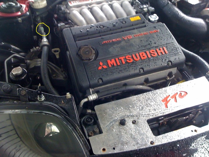

Yeah regas it but before you do take this cap off and shove something onto the pin and see if gas escapes... if nothing happens then you need to regas, but be careful coz it's apparently pretty toxic lol and you might need to figure out how the gas escaped in the first place lol

Oh thanks man! Ill check it out tomorrow and see what the go is there, never really had to deal with air com issues but I knew it wasn't working when I bought it.Sahin wrote:Yeah regas it but before you do take this cap off and shove something onto the pin and see if gas escapes... if nothing happens then you need to regas, but be careful coz it's apparently pretty toxic lol and you might need to figure out how the gas escaped in the first place lol

Okay just a little reply, Went round and did a good check and everything looks to be fine with my eyes, I Did the Pin thing to that valve and nothing happened didn't feel or hear any gas trying to come out, which i guess means i need to get a regas and i will probably ask them to check for any leaks too.

System gets pressure checked when they re-gas, especially if the system is empty; as a seal could have perished.
