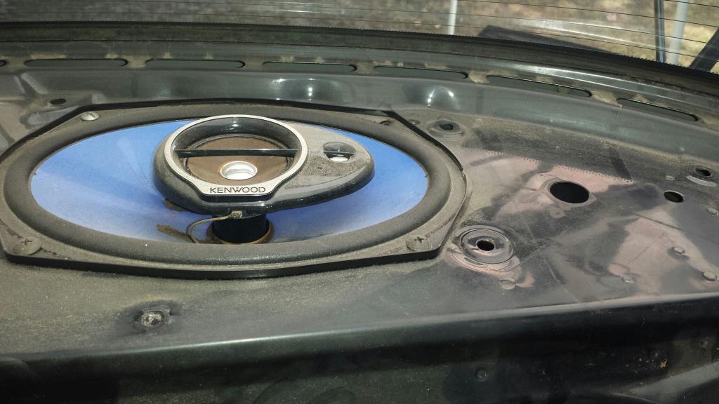

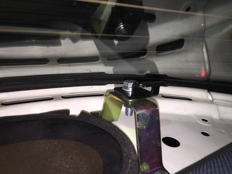

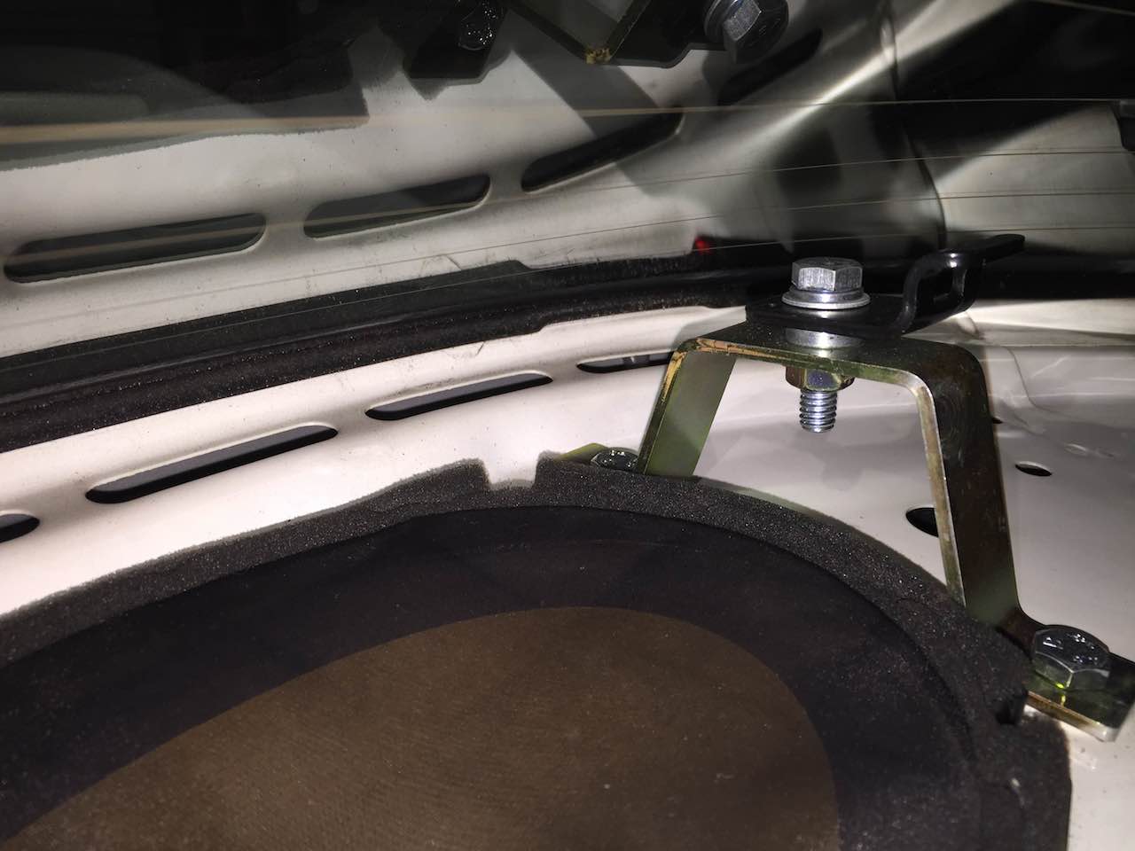

Herron, could you post a pic of your restraint, as i have never seen one and dont really know how it looks.
pic from above and underneath would be appreciated

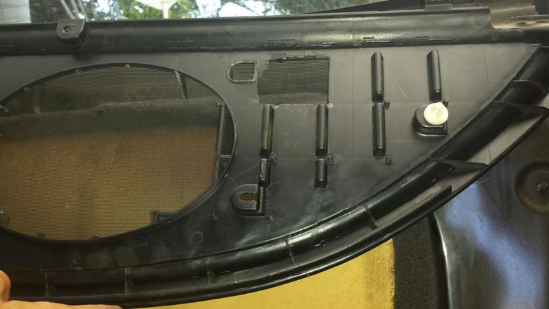

Re: child restraints
The FTO's never had child restraints from factory.
They have been installed for compliance to Australian standards.
I have removed mine and they are just a bit of steel bar bent into a bridge shape, a bit like this __/T\__
2 bolts on the lower flats to bolt to the parcel shelf and a threaded hole in the top for the restraint bolt.
The speaker grill would have 2 holes cut into it for the restraint bolt.
I can take a pic of mine tomorrow out of the car and a pic of underneath the parcel shelf, but I don't want to remove my speaker cover to show the mounting points from above.

herron, thanks for the excellent pics, now i know what im looking for
