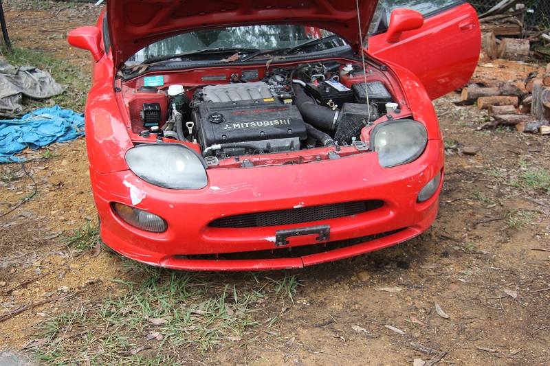

herro, here are some pics of my car.(the red one)

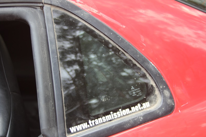

last weekend i fixed the broken window
I used a chisel to remove the glue. this is what it looked like when i pulled it out:
We bought some new glue and used this to glue in the new window.

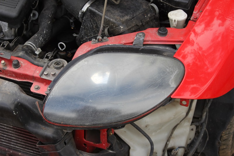

The next job was to replace one of the headlights. We took the bumper off and took a pic of the old headlight
We took the old one out and put in the new one and here it is all back together.

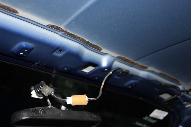

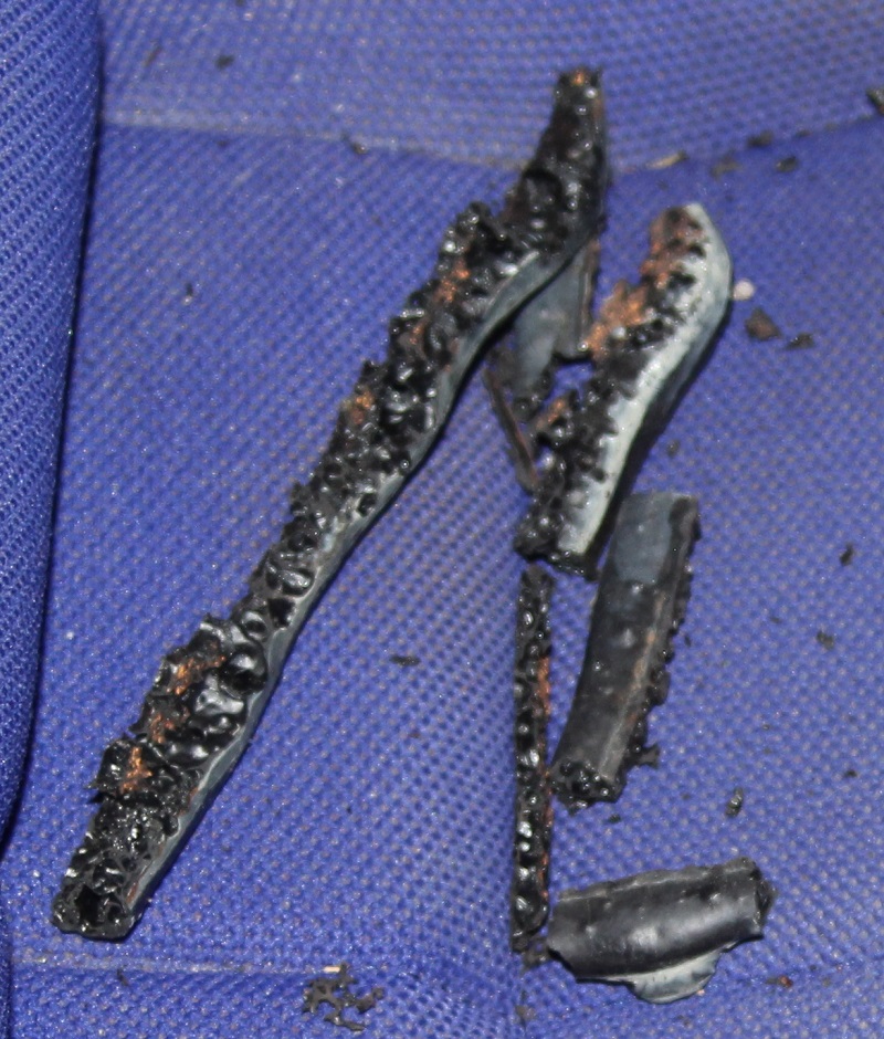

This weekend, we decided (me and dad) to remove the glue that causes the roof rust out of the blue cars roof. We removed the roof lining and used a hammer and paint scraper to get rid of the glue. Luckily we got it out before any bad rust had set in. Here is some of the glue

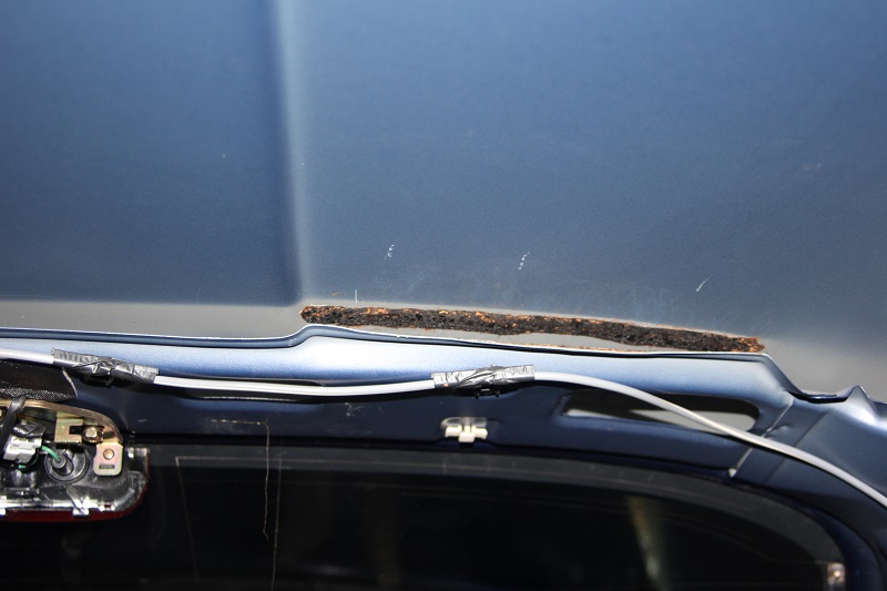

And here is the front roof without the glue. If you look carefully you can see small amounts of rust starting to appear.
And here is the back
Once the glue was removed, we used some rust neturaliser to get rid of the rust. We havent had a chance to prime it or put it all back together yet, so more pics when we do that.

Don't think I'd ever actually seen where this goes! Does on use a different glue to hold the headliner up, or is there another solution?
- dstocks
- National Vice President
- Posts: 9529
- Location: Utopia
Re: CamCar
Nah, you dont need it. Just remove whats there, prime and the jobs done
