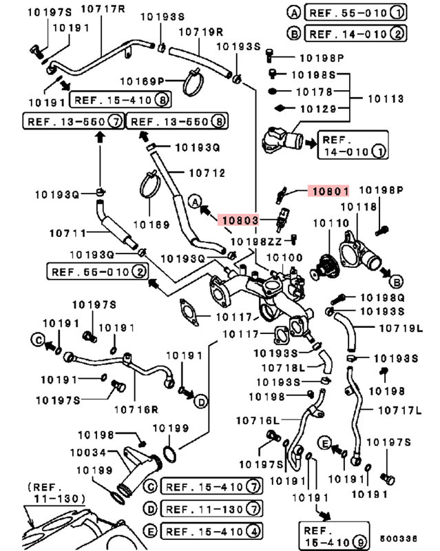

You can see them here on the VR4, one in front of the other, just to the right of the thermostat...

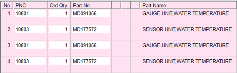

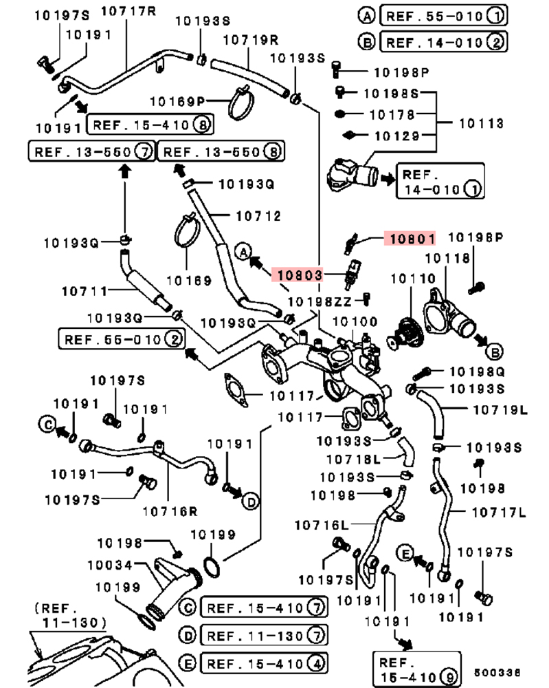

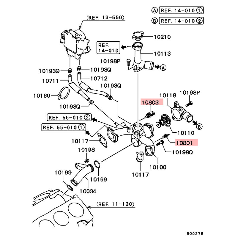

Here is the FTO... Here is the VR4... Here are the part numbers, 1 & 2 VR4 = 3 & 4 FTO...

Re: VR4 Starter and fan issues
Just looked up on ASA and they are indeed the same
