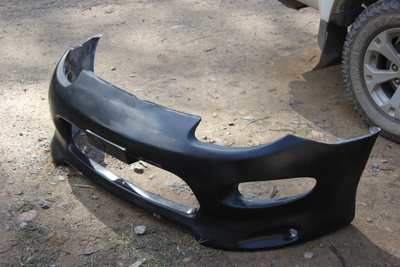

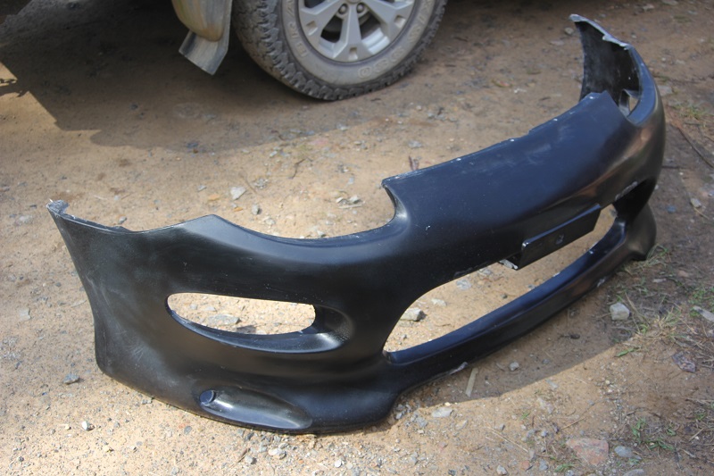

Had my first go at making a front bar out of the mould myself this weekend (Chris, the guy I use to get them made has been too busy lately). Not perfect, but definitely passable. Should be able to be more responsive with making these after a little more practice.

    What actually makes the difference in quality in terms of how it's done?
    Re: Fibreglass Moulds
    Pushing into the corners properly. If you dont get that right you end up with bubbles between the gel coat and the fibreglass and the gel coat sort of collapses on those points when you remove from the mould. Then you have to fill the holes and sand back and it takes a lot longer as a result. Of course, ive picked the hardest to do first (prefacelift TS Factory). I have to build the prefacelift pods into the bar ive made (lots of fun).

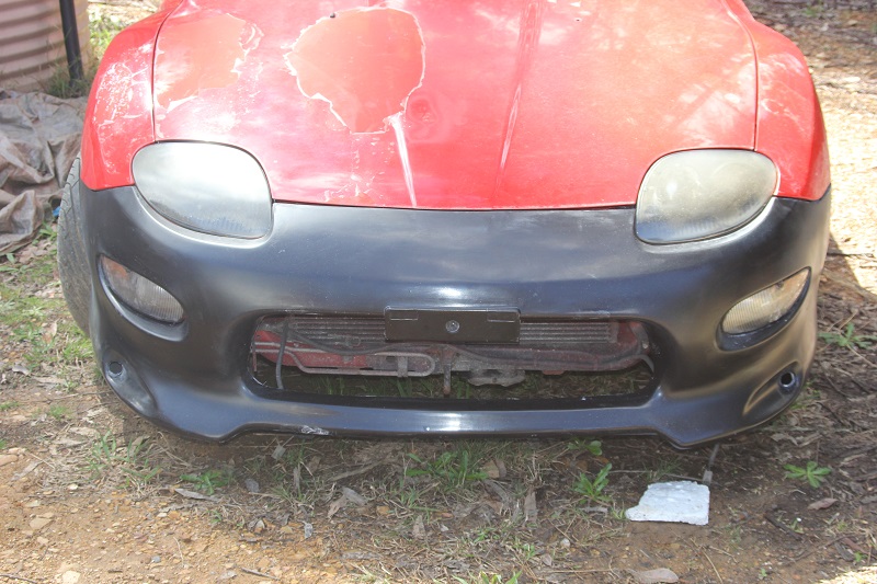

                Here is the first one finished....

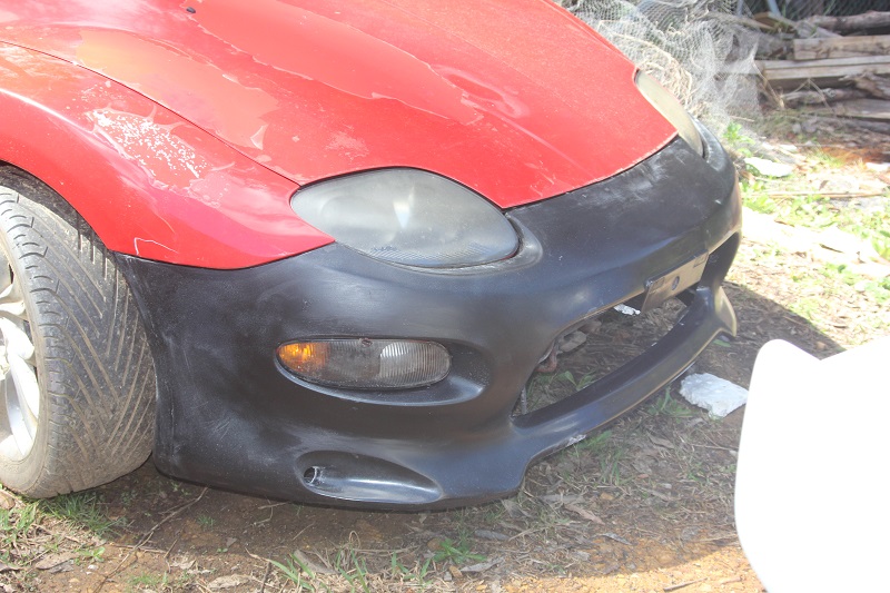

                  and the trial fit:

                    Nice! So glad you used the stock facelift front as the base for these bars. I think the shape looks markedly better than the others with the same DC lip that you see in Japan and the UK.
                    Yeah, but got to mould the indicators again fitted to the bar as there is a bit of work in getting them to fit. Unfortunately, that wont happen with this one as it already has a home to go to, so got to do it allover again and this took 2 weekends to get right. Next will be quicker though as ive worked out a few things now.
