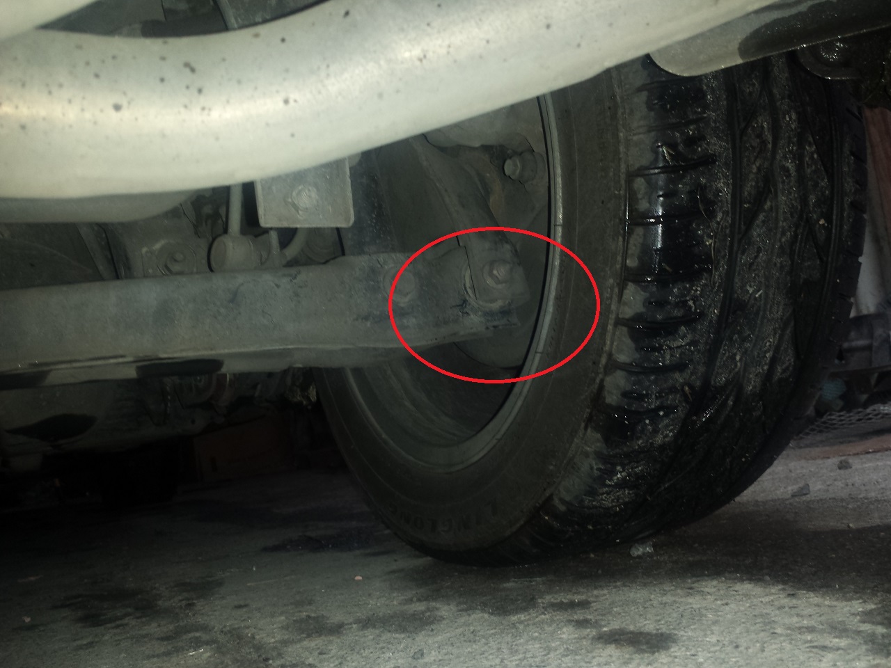

Right, so I failed my WOF today on the right rear lower outer control arm bush.
From what I can see it's genuine part numbers are MR197915/4113A062.
From searching on here it share these with the CE Lancer?
I can't seem to find an aftermarket one that I can buy locally. Mitsubishi NZ want $90 each and would take a while to get in.
Any ideas?
Any ideas?

Nolathane and Superpro bushes?
Re: The Suspension Thread
No local stores could find one that would fit, If you know of one, feel free to link it
This is the exact bush:

http://www.amayama.com/search/?q=4113A062
Originally called a MR197915
Common to CC & CE Lancer / Mirage.

I saw that one, but the description was confusing...
So that would be the right one to buy then? Postage time is annoying :/
Any idea of any aftermarket ones? Nolathane etc?

Yep, but you get both inner & outers in the kit.Technikhaus wrote:I saw that one, but the description was confusing...
http://www.superpro.com.au/superpro-par ... 00282&vid=

I think ZFL45H1 bought that kit and had to make new sleeves for them.Bennoz wrote: http://www.superpro.com.au/superpro-par ... 00282&vid=

Just ended up sucking it up and getting 1 from mitsi.Bennoz wrote:Yep, but you get both inner & outers in the kit.Technikhaus wrote:I saw that one, but the description was confusing...
$88 for 1...
