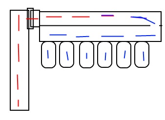

I want to end up with something like this:
But with a liquid/air core inside and water in/out on the ends running to a small rad and pump.

EDIT: Would that alone be enough though, as the point of impact for the first 2 runners is immediately after the initial hit of air.
OR
Are you creating like a tubed effect where by the intake will be split in the middle to allow the air to circulate??
IE
Where red is the air from turbo, purple is the air passing through fins/ radiator top side, blue is passing through fins bottom side after being cooled?
Just thinking comparitive size compared to volume of air, etc.

Astron_Boy wrote:ooooh, that's kinda funky.
That could even work quite well for a general N/A track car.
OR
IE
Again, I'm no expert, so...
Thinking more like this, flow isn't great but not much I can do about that apart from a shaped end tank which will help a little.
