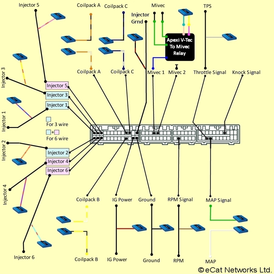

trying to figure out how to wire an emanage blue into the car but strugling to find a deffo pin layout.
iv found out where the injector wires go and thats about it lol
anyone able to help me out please:)

If you cant, here's the diagram :)

awesome diagram will look into buying one of these now :) also i noticed there is 2 mivec wires this is because there is 2 mivec solenoids yes? a bit off topic but does inlet and exhaust mivec kick in at the same time?

mattman wrote:awesome diagram will look into buying one of these now :) also i noticed there is 2 mivec wires this is because there is 2 mivec solenoids yes? a bit off topic but does inlet and exhaust mivec kick in at the same time?
When you're after one check out ebay.com seller bestparts4u and ask for a deal/combined shipping on the unit and whatever harnesses you're after (for turbo/supercharged you will need main, ignition and injector harnesses and a 3 bar map sensor with harness - that ones probably cheaper from Hong Kong).

only bit i dont fully understand there is the VTEC YO!!!!! to mivec relay?
im uing the r spec mivec controller if that helps

gavo's mivec wrote:only bit i dont fully understand there is the VTEC YO!!!!! YO!!!!! to mivec relay?
Ignore the v t e c to mivec bit since you are already using an r spec mivec controller which i presume is wired in and working?
That's if you don't have a controller, you can use the emanage instead but need some fancy mivec relay thing which you have to buy, they are like rocking horse sh*t apparantly.
BTW - I would tap into the r spec harness instead of chopping your factory wires as you then have plug and play.

yea its in and working and was plag and play so going to take it all off and sit in my room with the lot and a soldering iron lol
