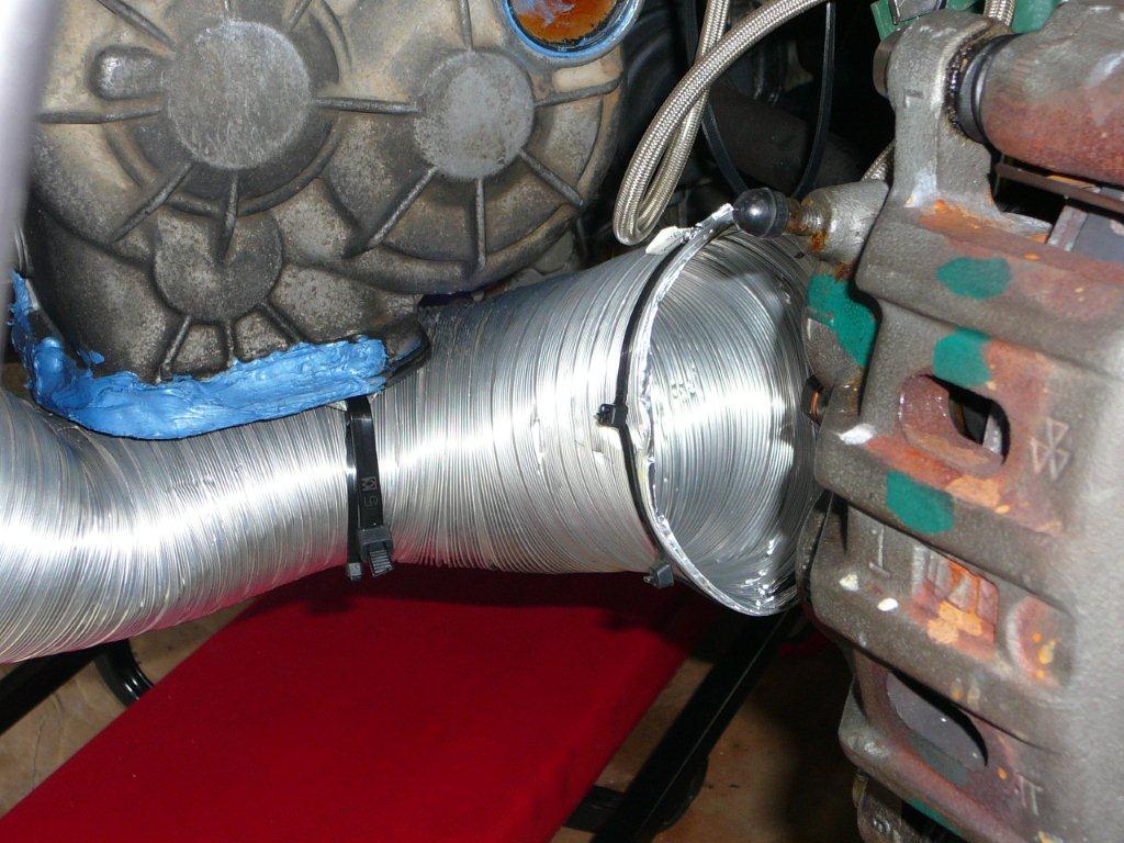

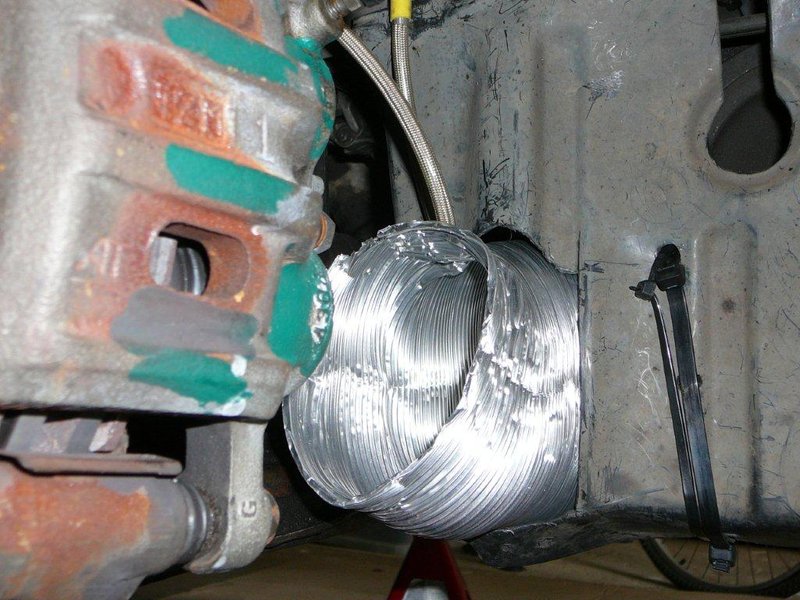

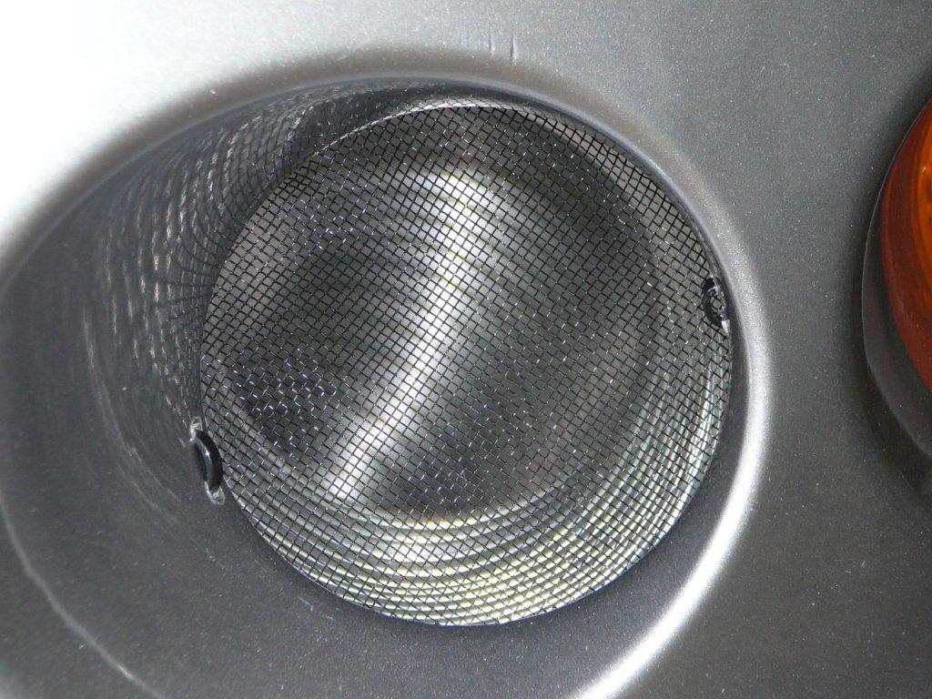

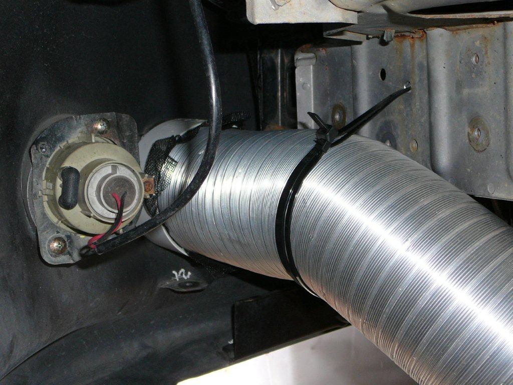

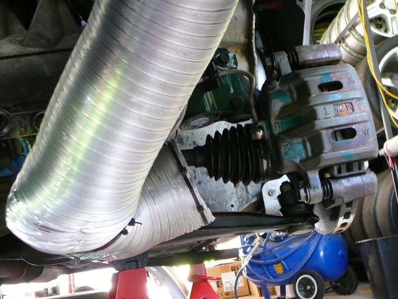

I'll let the pictures do the talking :)
Materials needed;
2x lengths of 100mm diameter aluminium rangehood ducting - Bunnings approx. $30 each.
Lots of cable ties.
Re: DIY: (Facelift) front brake ducting
Good mod if you don't have the factory driving lights installed!
Take you long to do?

Astron_Boy wrote:Good mod if you don't have the factory driving lights installed!
Now why would I need factory driving lights on a race track :lol:
Obviously this is not a mod for your average street car. Only needed for serious track work 8)
Yeah, fair point.
The merc has factory brake cooling ducts built in to the bumper (meanwhile those brakes have to cope with near 2 tonne...)
A lot of peeps don't have the driving lights due to compliance, so a good mod to make use of the holes!

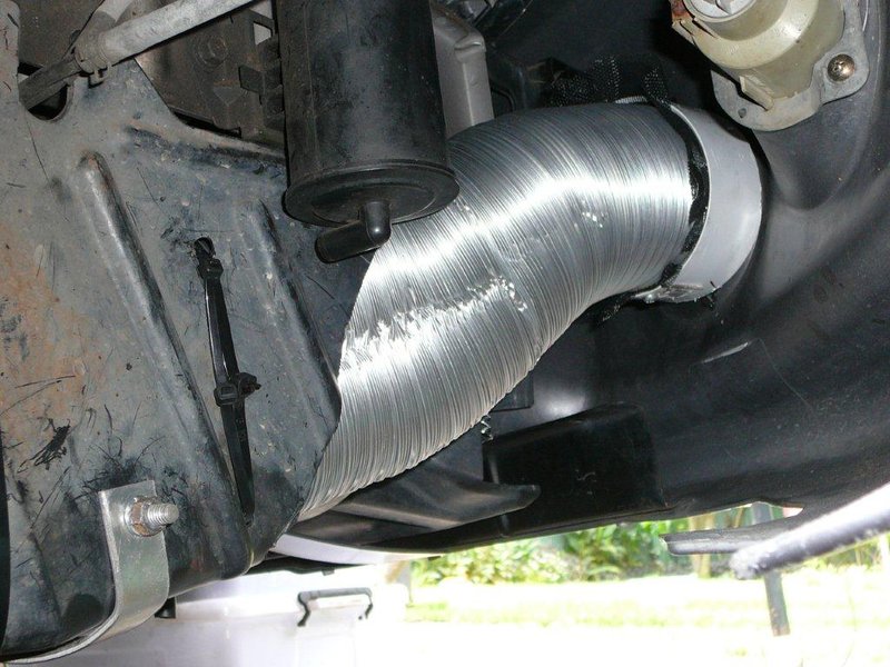

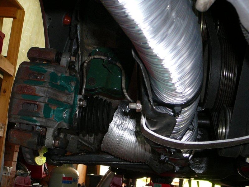

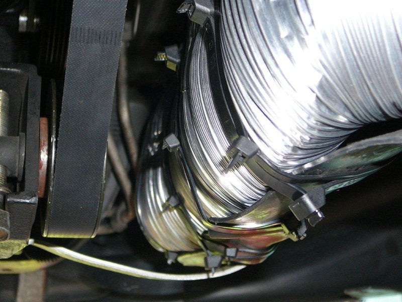

How close is the ducting to the belts 8O
Supplanter wrote:How close is the ducting to the belts 8O
Close enough :lol:
There's plenty of clearance, 1 to 2 inches, and it's all held rigid thanks to the alloy bracket in the pic.
