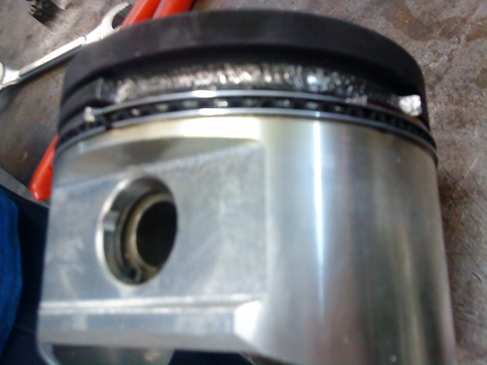

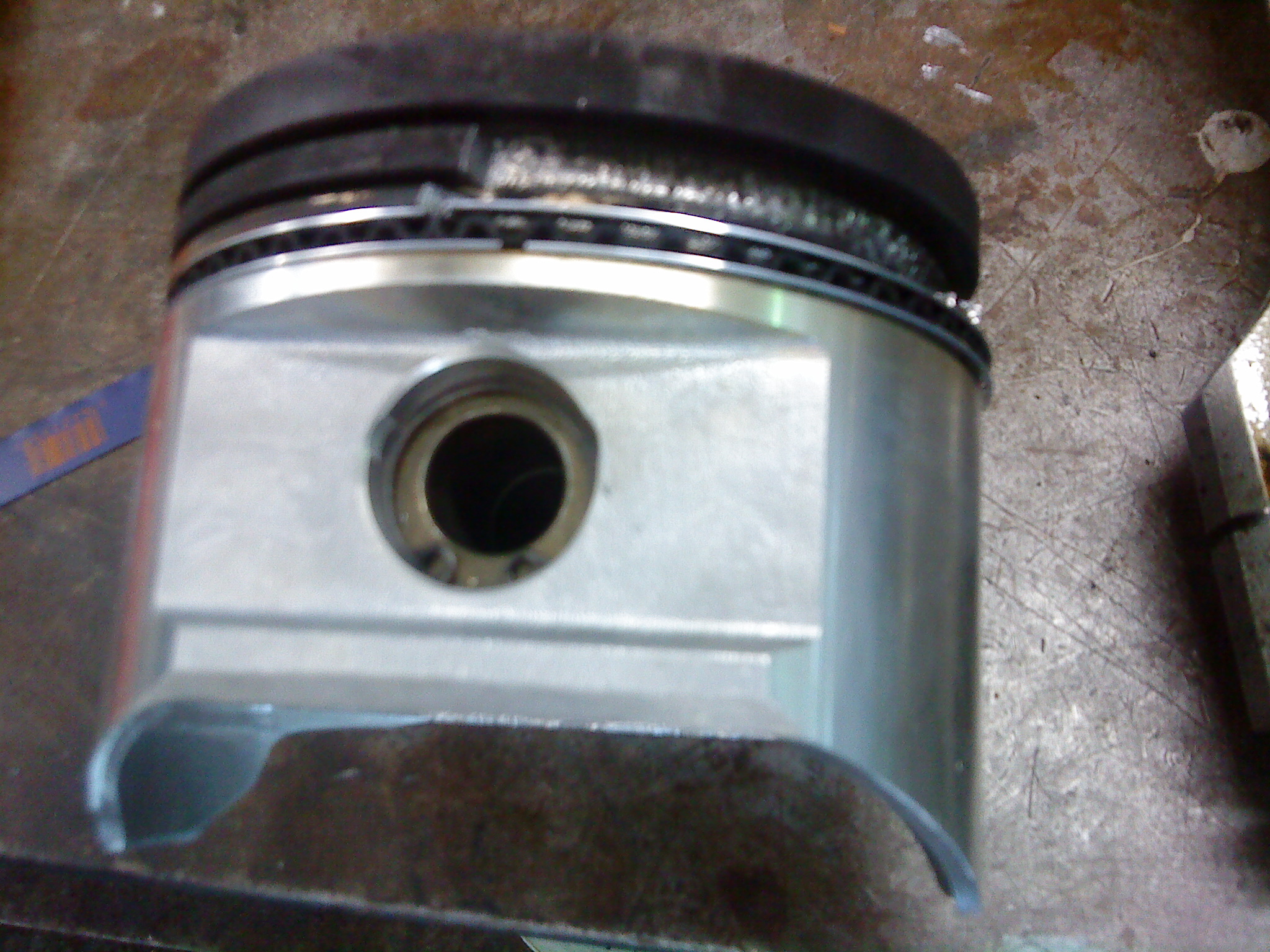

Annnnnnnnnnnnnd BANG!!! Again!!!
This is what happens when you run around for 3500kms without having it tuned... So rich it ripped the pistons to peices & polished the bores to a mirror finish. Most of the rings ended up in the sump.
Lesson learnt, it doesn't matter how much you spend on forgies, if the tune aint right, you'll f**k them with ease.
