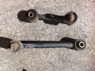

Do these exist aftermarket
I need to if anyone has replaced these bushes if so where did u get them if not any ideas

The 2 smaller dog bone links are available aftermarket:
viewtopic.php?f=10&t=5944&start=300
About 5 posts down

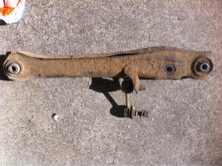

The lower control arm you need buy the bushes from Mitsubishi & press them in.
Part number is 4113A062

Pretty sure kelpro/mackay already do the FTO bushes as they are interchangeable with other models.
What price do you think you can do it for?
