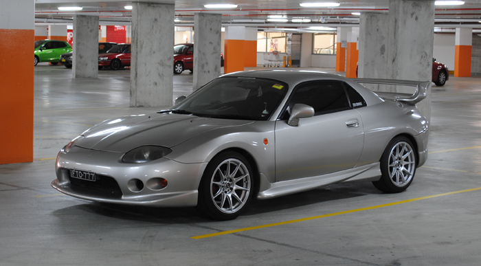

I have 17x8.25" wheels with 215/45/R17 wheels, they do scrub but only on the plastic inner guards when i hit dips in the road or have the wheels at full lock; not the edge of the guards and mine aren't rolled at all... not sure exactly how much lower than stock my car is but here is a picture for an idea.
I think to get it really low you would have to say goodbye to the plastic guards all together especially at the front as they are level with the edge of the outer guard and possibly go for coilovers instead of a shock + lowering spring setup.

Cool thanks man that the same height i'm wanting. Do you have coilovers? Or if not, do you know what brand the springs are? Cheers
