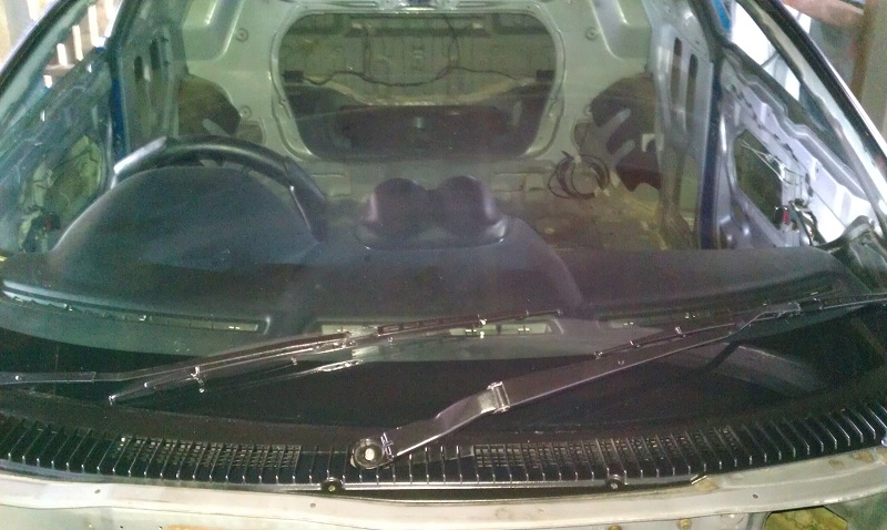

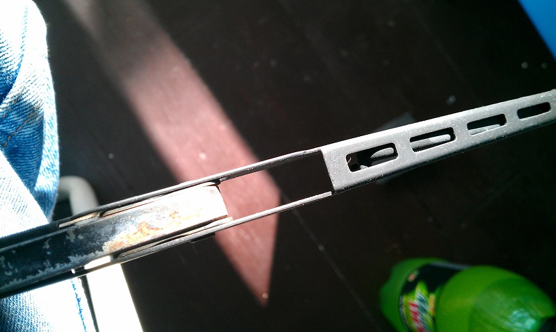

Firstly, get some sandpaper and rub back the wiper blades, what you are really aiming to do is get off all the surface rust and loosely flaking paint - you dont have to sand it back down to the bare metal, but make sure paint will not continue to flake off and that it is a relatively smooth surface. This is an example of mavericks before sanding.

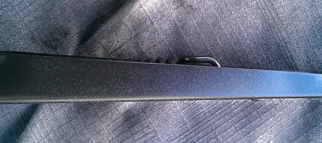

Once the final coast is applied and HAS DRIED OVERNIGHT (do not attempt to sand in less than 24 hours) it is optional to lightly sand back the finished blade with some wet and dry 1200+ grit very lightly to smooth it out, however i skipped this as its not really a determining factor in the overall end look.

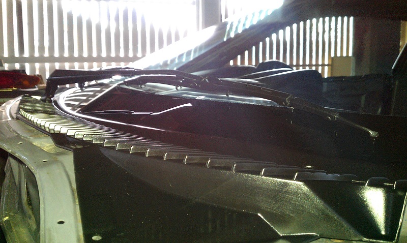

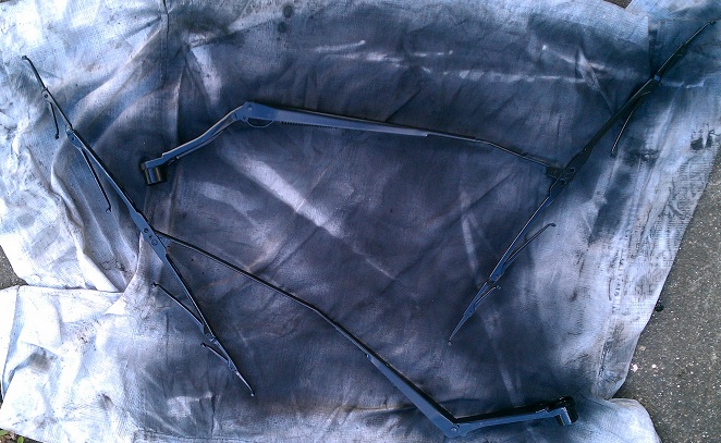

Your final product should be of high quality and noticeably better than just a newspaper on the windscreen and just spray them job. This is how mine turned out:

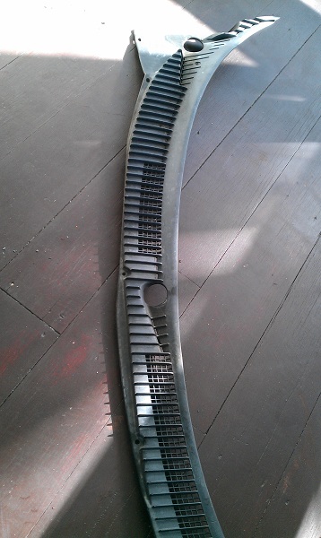

This was mine before i started - faded to hell and looking a bit drab.
Sanding this i was probably a bit lazy, i went over the top part briefly and the sides, but didnt bother getting in between all the crevaces that basically make up the thing, because im gen y and lazy and because it was only faded, not really damaged. Then wipe over the entire piece with some turps which should dry very fast. You should be left with a clean surface now.

After a few coats you should come out with a significantly higher shine/gloss filler than it was, this is mine afterwards:
