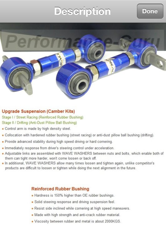

Also u can get these for that little extra touch ![laughing :lol:](./images/smilies/icon_lol.gif)

Any chance that would fit on a FTO? or a they made universally?ZFL45H1 wrote:Also you can get these for that little extra touch

The megan arms? No theyre not universal, but there is a kit for the fto, looked into it the other day, its 220 plus 100 postage ![Shocked 8O](./images/smilies/icon_eek.gif)

That's pretty standard price-wise when it comes to racing components. Hell, even new genuine replacements will cost more than that. It's got all the bushes you need, as well as a higher achievable adjustment setting for "race use only". Postage is a bit dear, but otherwise pretty good.Taz wrote:its 220 plus 100 postage

Right found them I know they say Evo 3 but I'm su're bonnoz said the rear of the fto is this so here we go
http://item.mobileweb.ebay.com.au/viewi ... 3955214130
Also for toe
http://item.mobileweb.ebay.com.au/viewi ... 6413378807
Also for toe

yip camber bolts gave me -2 of camber never moved on me either... Now run coilovers with adjustable tops reckon could get about -5 out of them but no need of course.
As for rears the factory gives up to around -3 but this will also depend on condition of bushes etc and not a bad price for those arms early evo ones do fit but that postage is a bit exp

True little high on the postage but if your a keen racer they would he great hahaha

Was alarmed at the postage, the price seems pretty good actually.

The one ZFL45H1 mention a better priced $195 and $33 AUD for shipping
