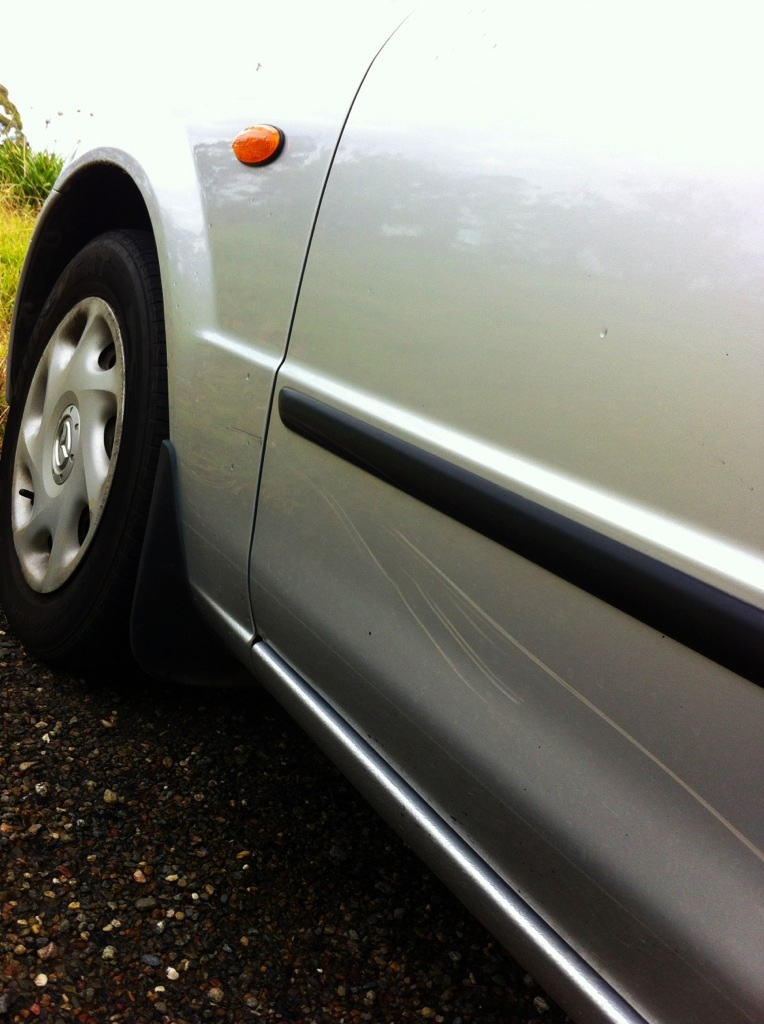

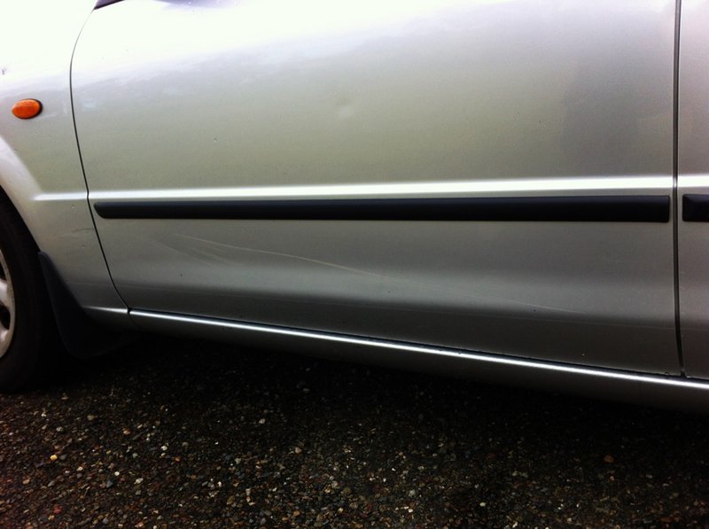

My sisters selling her car soon and has asked me to fix these scratches. She was taking it to a panel beaters and got quoted a ridiculous amount. So I said I'll do it.
It's a pretty simple really all I need to know is can I just sand it back abit and paint it or will they still show or the paint not stay on?or Do I need to sand that whole bottom bit of the door back then prime and paint etc?

Depending on how deep the scratches are, you should be able to get away with a good cut and polish and a decent buff. Okay, how handy are you with a cordless drill?
If the answer is along the lines of "I know which end screws things" then you're set! You will need:
1x Waffle Pad
1x Lambs-wool (or similar) buffer pad
1x Cut + Polish product (I'd say Meguiars, but really whatever works)
1x spare day.
Follow the instructions on the back of the cut + polish product, and you should be set. Alternatively, here's a youtube link:

The scratches look like they are also dents. You would have to sand back the lower section of the door (from the side trim down), bog the indents, spray primer filler, sand, paint colour, paint clear. I would leave the door on and just cover the rest of the side of the car with paper/tape. Sand and bog with door open, paint with door closed.
The biggest problems would be colour matching and blending in the new paint with the original paint work.

Too much effort. Unless the cosmetic damage is significantly decreasing the sale value or if she is getting a big amount from the sale which covers the cost of fixing it and some more, I would try and sell it as is.

Also keep in mind that if you do try and fix it, you could end up making it worse and look like you're trying to cover something even worse up.

They are fairly deep scratches though, not dented but deep.Bennoz wrote:Just polish them. Will hardly notice.
She really wants them gone before sale, dunno why exactly but really wants me to have a go.
And yea I'm worried that ill make it look like something worse then what is there. I could see this happening only if I have to use filler,.

You can try using a bit of touch up paint and then wet sand with some 2000 or 3000 grit wet or dry, followed by a good buff.
Re: Some help please
Yep I'm thinking that's probably the easiest, cheapest and most effective way too do it. CheersVectose wrote:You can try using a bit of touch up paint and then wet sand with some 2000 or 3000 grit wet or dry, followed by a good buff.
Now I gotta tell her she doesn't need the $40 can of paint she had mixed up for me

Use the paint that's in the can to touch up, spray it into a little container.destinationtoby wrote:Yep I'm thinking that's probably the easiest, cheapest and most effective way too do it. CheersVectose wrote:You can try using a bit of touch up paint and then wet sand with some 2000 or 3000 grit wet or dry, followed by a good buff.
