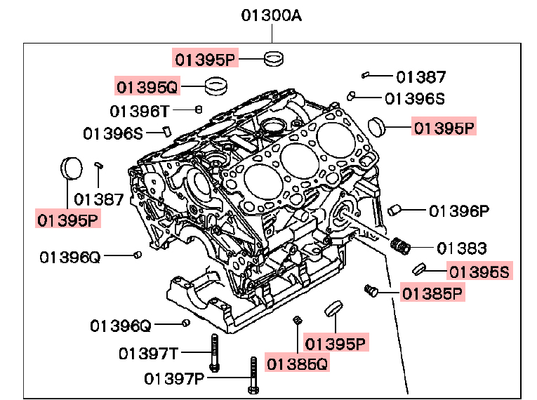

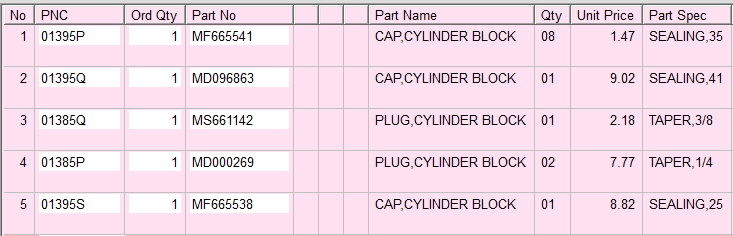

I don't know the sizes but here are the Mitsubishi part numbers, just go to Mitsubishi Aust and get them.
Note: The part numbers start with "M" in the list.
Note 2: The actual sizes could be the numbers under "Part Spec" but I am unsure.
Note 3: Look at the exploded view to find the one you need and then reference that number to the list.
This is for a MIVEC engine
Pics...
Pics...

Probably the same, it's the same block. Welch plugs are generic, you can get them anywhere, just be precise when measuring your size.
