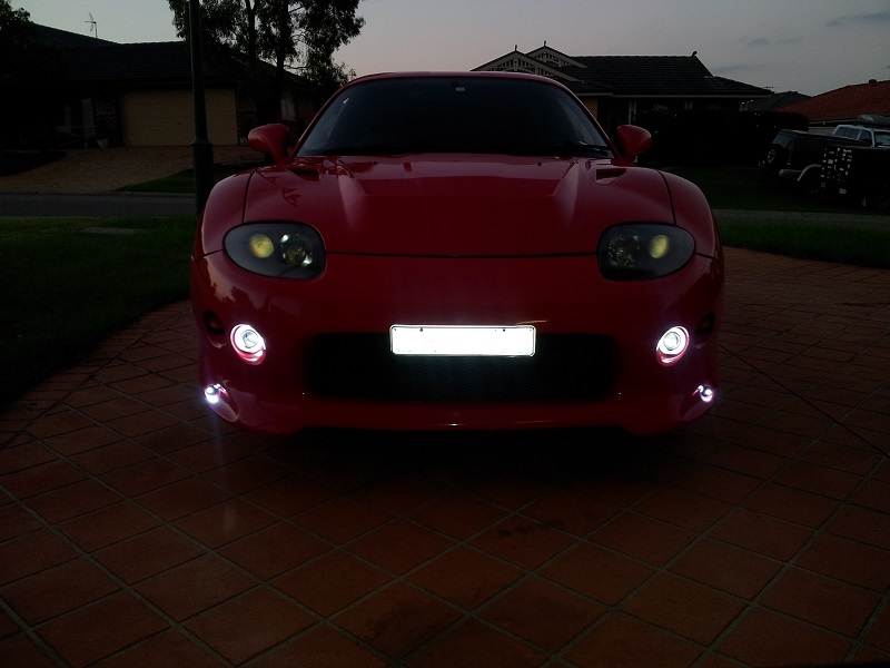

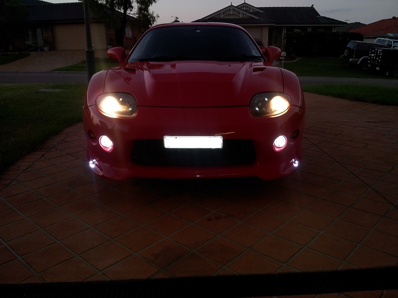

Well you were right, yet again. Turns out you can never trust a simple continuity check. Sure it flows power, just not enough to ignite the parkers. I noticed the contact points on the little sea-saw like actuator inside the fog light switch were pretty corroded so I filed them back a little. Check with ohm meter instead of stupid buzzer for better accuracy and hey presto it all works.dstocks wrote:Your switch will be buggered - common issue. Remove switch, unplug and check for burn/scorch marks on the back of the switch.
Wasted a little time checking wiring but I went with my gut and followed your advice.
Cheers dstocks
- Halos
- 20140222_194740.jpg (103.45 KiB) Viewed 462 times
- Foggies
- 20140222_194708.jpg (114.65 KiB) Viewed 462 times

Re: Fog Light Wiring
Where did you grab those foggies from? And what are you using for the small lights the bottom vents?
Looks mint
I wouldn't rely on that switch for long though, most of us have supplemented it by adding a relay in behind it. The switch on its own will burn out.
Little lights are just the parkers, bought the LED ones though.
I got the fog lights off ebay with some help from dstocks.
