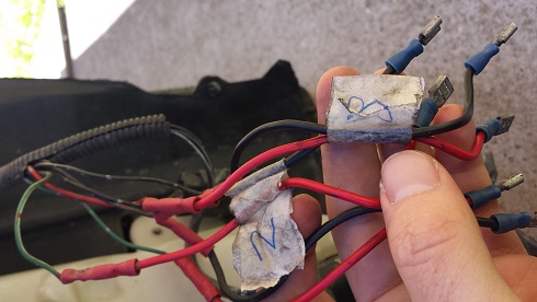

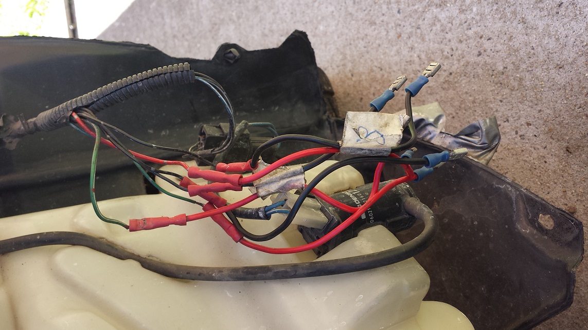

So basically my parkers/fog lights were screwing up a lot and they were very dull when they ever did work.
I decided today to take the bumper off to sort it all out..
All was going fine and I replaced both parkers with no issues. however as you can see from the pictures below, the wiring on the passenger side cluster is completaly f***ed
this is casuing the wires to touch and to short out constantly :/
anyone have some ideas as to what I could do to secure them so that this doesnt keep happening?

Re: Pre facelift light cluster wiring
Rip all the old sh*tty tape/heat shrink off then strip off all the old solder and crap.
Re-solder then heat shrink properly and she's good to go.
Buy the plug from someone wrecking.
Just make sure they leave you enough wire to connect to.
Ive got plenty of them. I can probably find a crappy one with Ok wiring.
