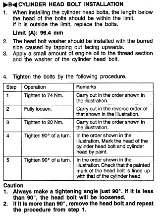

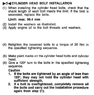

So I was going through the engine and workshop manuals and each one has a different procedure for tightening the head bolts. Which one is correct?
Engine Manual - Head Bolts.jpg (49.5 KiB) Viewed 265 times
Workshop - Head Bolts.jpg (77.95 KiB) Viewed 265 times
Re: Head bolt tightening procedure
The most recent one, presumably? :lol:
Both manuals were published March 1998. :lol:
Vectose wrote:Both manuals were published March 1998. :lol:
But which day in March!
More to the point hours minutes and seconds lol
Just zap the c**t with a rattle gun
Daniel2019 wrote:Just zap the c**t with a rattle gun
I do it til they can spin freely right?
BTW, went with the one in the workshop manual.
