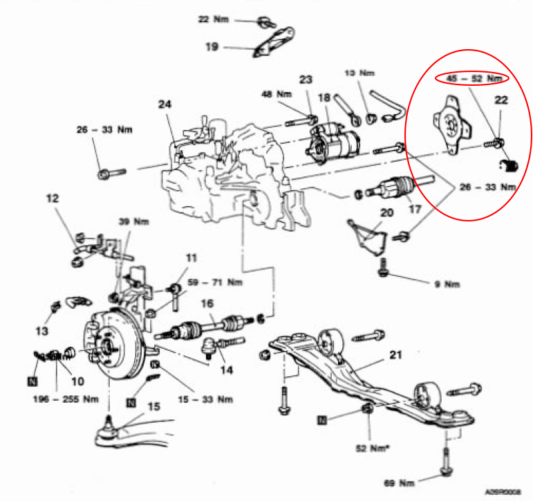

      Workshop Manual says 45 - 52 Nm

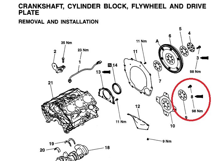

      I stopped the engine from spinning with a long breaker bar on the crank bolt going to the ground, because I didn't have anyone to help
      Drive Plate Bolts.jpg (187.02 KiB) Viewed 666 times

        It's 45-52nm for the bolts that attach the torque converter to the plate. The bolts that attach the plate to the engine are 98nm.
        Flywheel Bolts.jpg (88.79 KiB) Viewed 656 times
