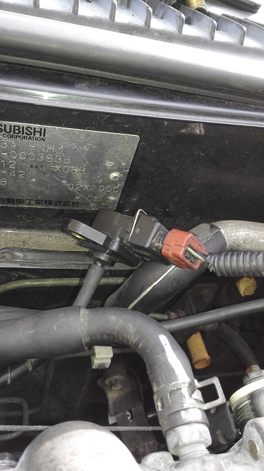

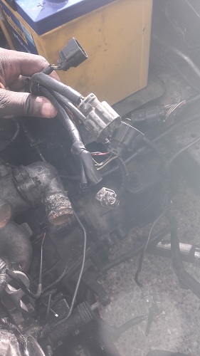

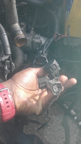

This are what have been talking about. Got one plug to the gearbox and the other ones have no idea where they go

Re: Plugs need homes
Sensor near throttle body is an wps sensor
2 smaller plugs are auto gearbox input / output sensor
Bigger sized plug gearbox solenoid connector
Medium sized plug inhibitor switch.
