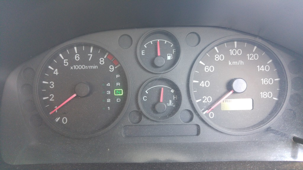

Anyway, I notice when I go slightly higher rev, my temperature gauge will go up to 3/4 like the cluster pic as shown above. Both fans are working, water is full, but it gets above normal working temperature.

Hmmm, radiator could be blocked. Could also have a blown head gasket. Are you using water at all. I wouldnt think its a sensor or gauge. Could be a blocked water pump too.

Could still be a sensor. See if it actually is overheating using a temperature gun.
Might just need sensors. My blue GPX had that issue - gauge was reading high, was just a gauge sensor.

Maybe I start with a simple job like remove thermostat and do a complete flush first?
Re: Greeting from Malaysia
Yeah thats where I would start.
