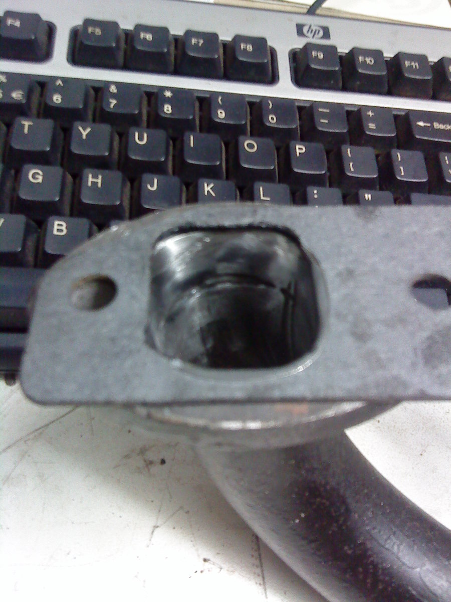

I just noticed that the original gasket protrudes inside a tiny bit too which I presume is because the heads have had a P&P and the Y section was match ported.
I bought some permatex fuel resistant gasket sealer and will grind out to gasket match the heads and reuse my current gaskets... Hopefully no issues otherwise will need to wait the 2 weeks and then replace them

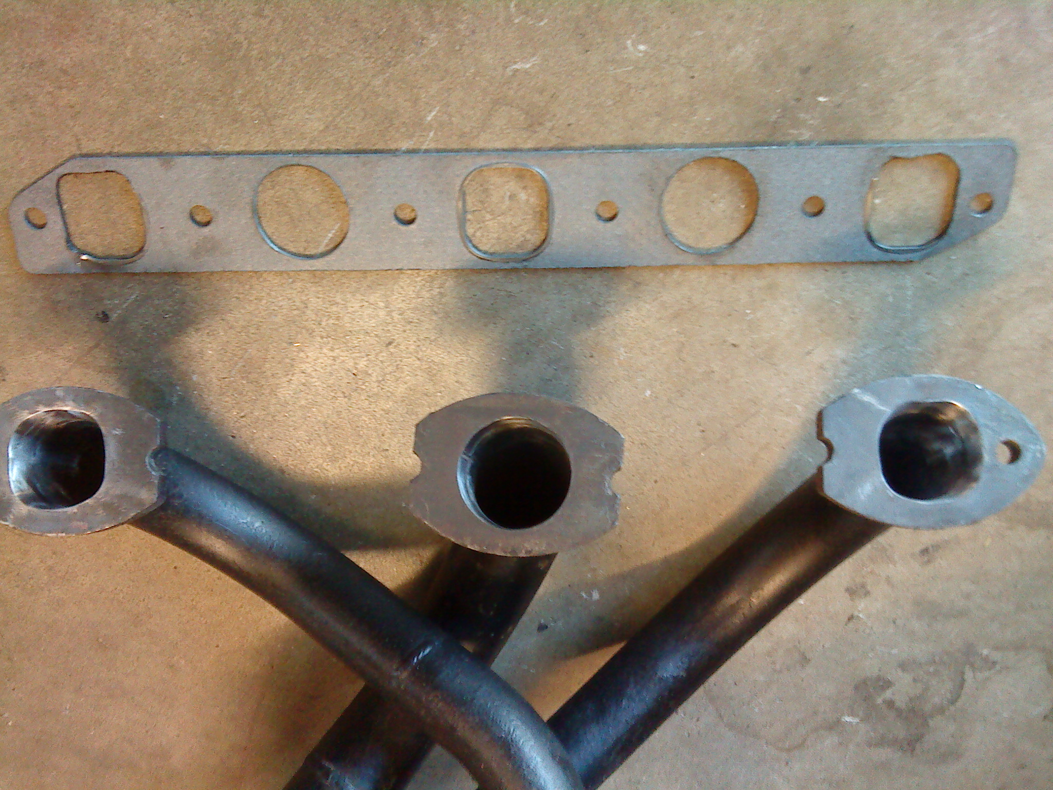

I would've bought a couple. Match porting gaskets to ported heads & exhausts is a pain in the ass & you inevitably end up trashing one in the process.
Did the mini a few years back..
Re: Intake manifold to head gasket - Single use?
I'm going to practice on my old ones and then hopefully get the new ones right.
Not much material needs to come off really, it is just a slight protrusion
