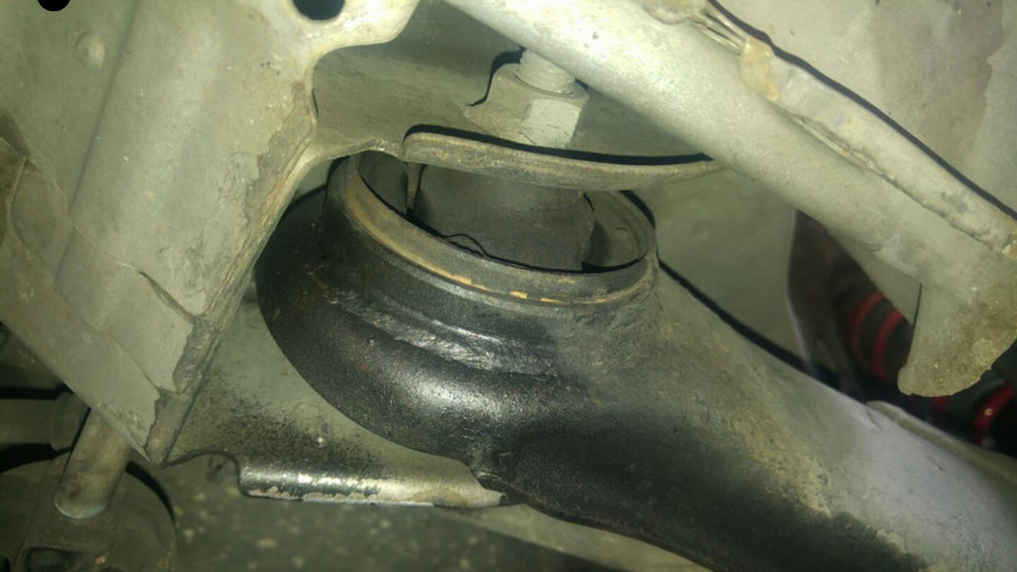

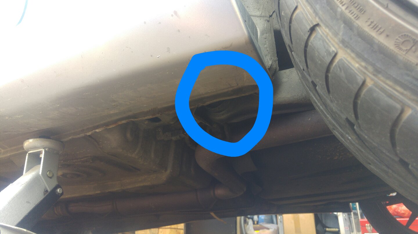

My mechanic has told me that I need to replace these 2 bushes (the rear squeaks) as shown in the pictures (both in the rear of the car) and I was just wondering if anyone knows the names/where I can source these 2 bushes(I live in Sydney)?

Re: Names of these 2 bushes?
rear trailing arm bush and rear lower control arm bush
Thanks for the helpSahin wrote:rear trailing arm bush and rear lower control arm bush
http://www.ebay.com.au/itm/MITSUBISHI-F ... 1982248735
That would be the right part for the rear lower control arm bush right?
Would you by any chance know what the part for the rear trailing arm bush is, all i can find is http://www.ebay.com/itm/Mitsubishi-FTO- ... 1404025007 but i believe this isnt the right part?
Thanks for your help man
That first link is for the front control arm.
The second link is the rear trailing arm bush which is the one that is somewhere underneath the rear seats.
The rear lower control arm outer bush I believe is a spherical link and shouldn't really need replacing (someone correct me if I am wrong).
As mentioned above, second link is correct for the rear trailing arm bush.
The other bush is the lower control arm outer. It's a HYME style joint & can wear out. The Superpro replacements are all over the place, so I'd go genuine: https://www.amayama.com/en/part/mitsubishi/4113a062
Thanks a lot for the help guys, cheers for the link aswell, I just ordered a pair.Bennoz wrote:As mentioned above, second link is correct for the rear trailing arm bush.
