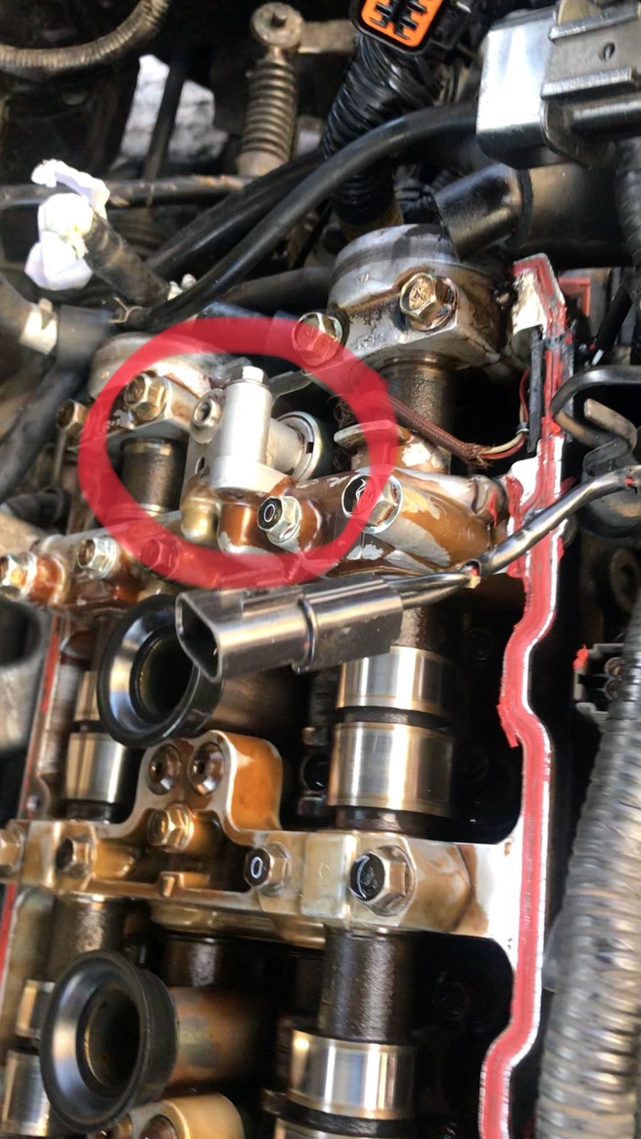

Hello Guys,
A small update.
Managed to locate that damn thing. In case someone is looking for that solenoid, it is located on the right side under the rocker cover (find attached pic).
You just need to remove the inlet manifold (which was quite a pain in my case
) and remove the rocker cover.
PS: Please excuse my dirty engine bay. This is the first time i open that bloody thing.
