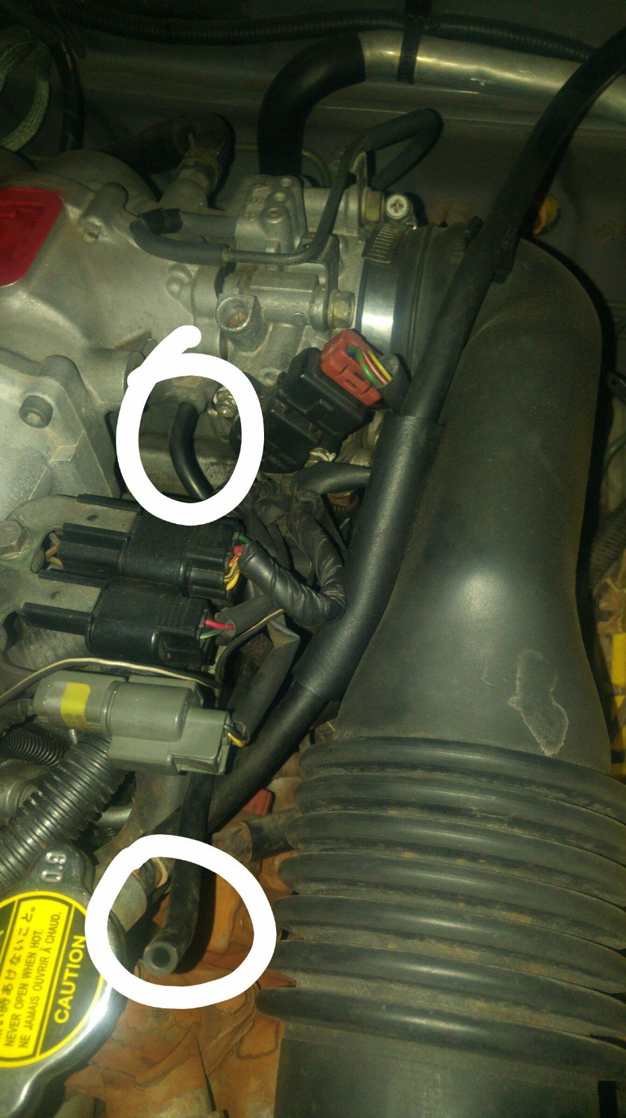

Hey
I randomly just noticed this loose air pipe that seems to be sucking air that isn't connected on one side? And I can't seem to figure out where the otherside is suppose to be connected as I don't remember it ever being like this. Would anyone be able to help me?
Thanks in advanced!

Have you taken your air intake off at any time?
It's been some time since I have looked in the fto bay, but I think the other end plugs Into the intake pipe.
Re: Loose air pipe?
I don't think that's the breather pipe, from the EPC data kinda looks more like the one that plugs in by the fuel rail?
Re: Loose air pipe?
I believe it could be the fuel pressure regulator vacuum hose?

Hmmm I'll check some of the spots out thanks. If it helps when I put my thumb over the end, the car idles lower than when it does when it's just sucking air in.

Re: Loose air pipe?
Post by Nacho »
+1 runs to fuel pressure regulator

bjk wrote: ↑Sun Sep 02, 2018 10:41 pm I don't think that's the breather pipe, from the EPC data kinda looks more like the one that plugs in by the fuel rail?
Winner winner 👌, thanks so much for the help everyone! Appreciate it
