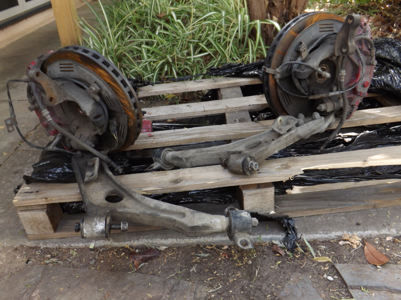

If you trust my eyeballing of the centre of the tyre, the track width on my car is 1490mm with the Evo VI arms and hubs, which is unchanged from stock. Like Rob says though, they do add more caster angle (which is good) unless your tyres start clipping the front of the guard/bumper tab (which is bad).
Arguably overkill for a stock-power FTO, but if you find yourself if want of the Brembos, certainly the most bolt in solution is the whole LCA and knuckle from either the V or VI (they are different however, get the VI if you can).

Thanks, BJK - your pics are always so helpful!
That settles the question of track width. I'll reciprocate with comparisons of the LCA if/when I get a pair in. But you both know what I've been pondering

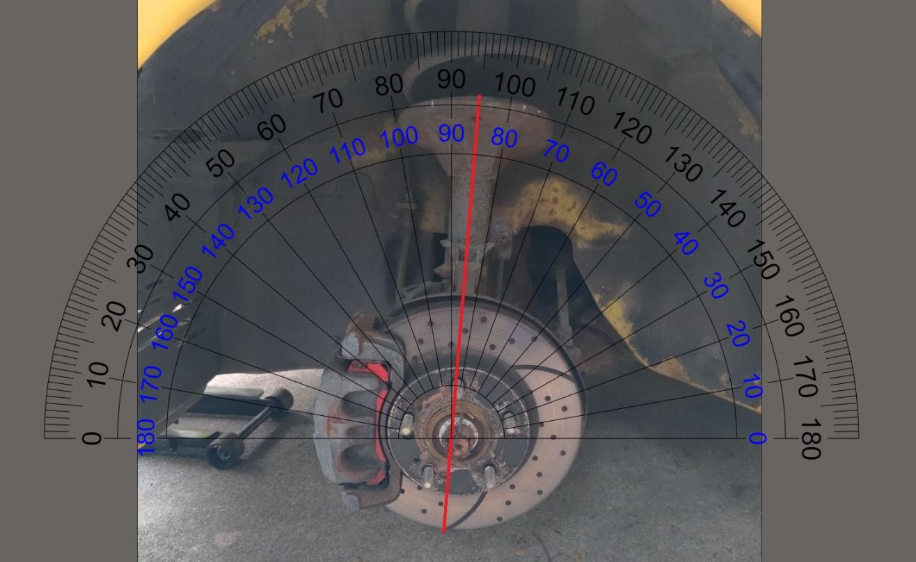

Re: Version R Subframe - ARB Brackets
I also didn't realize I took pics of the suspension with the car lifted.
To your point, BJK - here's to eyeballing stock castor.
I know - it's silly to measure using pictures. Better than nothing.
I think my camera angle was perpendicular enough to the ground. Looks like stock castor is about 5* positive, lifted. On the ground, on stock height - I dunno, probably within the typical 7* range.
From what I've seen on a few spec sheets of supposedly accurate origins (just on random FTO websites), stock caster is about 2.5 deg. The Evo arms and standard bushes gave me 4.5 to 5ish degrees, and the reversed caster bushes brought them back about 0.75 deg. Might not have been required if I was running a smaller diameter tyre, but I think I still had the 235/45R17s on and it was grabbing the left sidewall.

Oh god - yes, those would definitely rub! That was the same tire diameter I used during my "test fitting" the Evo BBS wheels.
5* of castor I imagine wouldn't be bad - better in fact for turn recovery stability (how much exactly - only a person who's tracked the car with both setups would know). In any case, thanks BJK - so helpful as always!

Stock FTO caster should be in the 3 degree range I would expect.
The Evo wheelbase is 10mm longer than a standard Lancer sedan.
The Lancer sedan and FTO wheelbase is identical.
So as mentioned the Evo LCA's would extend the wheelbase by 10mm to gain more caster.
I use caster bushes and reverses the coilover top mounts on my car which got me about 6.5 degrees of caster and the car didn't handle well. From everything I read this should not have been the case but a reduction in caster gave me a lot more front end grip.
As for track width, I believe most of the additional track of an Evo is from a different offset wheel however it seems the LCA might add some too

Interesting - thanks Spetz. I'm all clear for now. Prime example of how suspension tuning is really an art, and where each component can change the effectiveness of the overall solution.
So, to summarize from everyone's input thus far, the effects of switching to Evo IV-VI front LCAs are:
- +10mm wheelbase (spetz)
- +4.5 to 5* castor, associated with additional wheelbase (bjk)
- Possible increase in track width (unknown), but likely not by much
- Castor correction bushings roll additional castor back by about 0.75* (result: +3.75 to +4.25*, based on bjk's readings)
