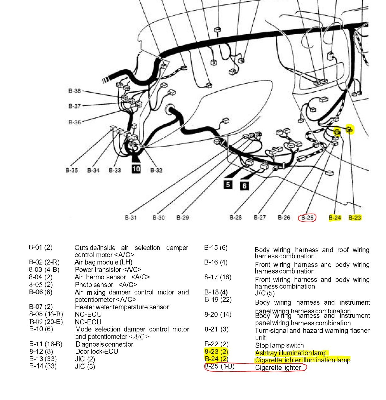

Looking at wiring diagrams from the FSM, I'm going to take a stab and guess that one of the two T5 bulbs goes to the ashtray. (B23) Just like Supern0va said. Car's not here to physically verify.
Sadly, the wire color codes on this manual are crap so it's hard to confirm - but if that connector you're looking at is bundled in with your cig lighter, could it be that it's to a secondary 12v Cig outlet? What's not pictured below is B-26 says cig lighter as well. See if this white connector matches the cig male connector and do a quick volt/amp test to be sure. At best you have another free aux power source, without needing to tap into your steering harness!

supern0va wrote: Tue Jul 14, 2020 11:59 pm
also the other globe goes into the cigarette ash holder (the first bit that you can just take out super easy) you will notice a small clear screen which provides light to go through, it goes into there.
i recently pulled my whole interior apart to remove the sound deadening which is why i know this lol
You were close but not correct.
The extra bulb actually goes into the fixed housing of the ash tray, not the piece that pulls out easily. Ive attached a pic to show where it goes, it lies directly underneath the small clear screen which acts as the lens for the light. I missed this bit in the dark last night, but your post pointed me in the right direction.
