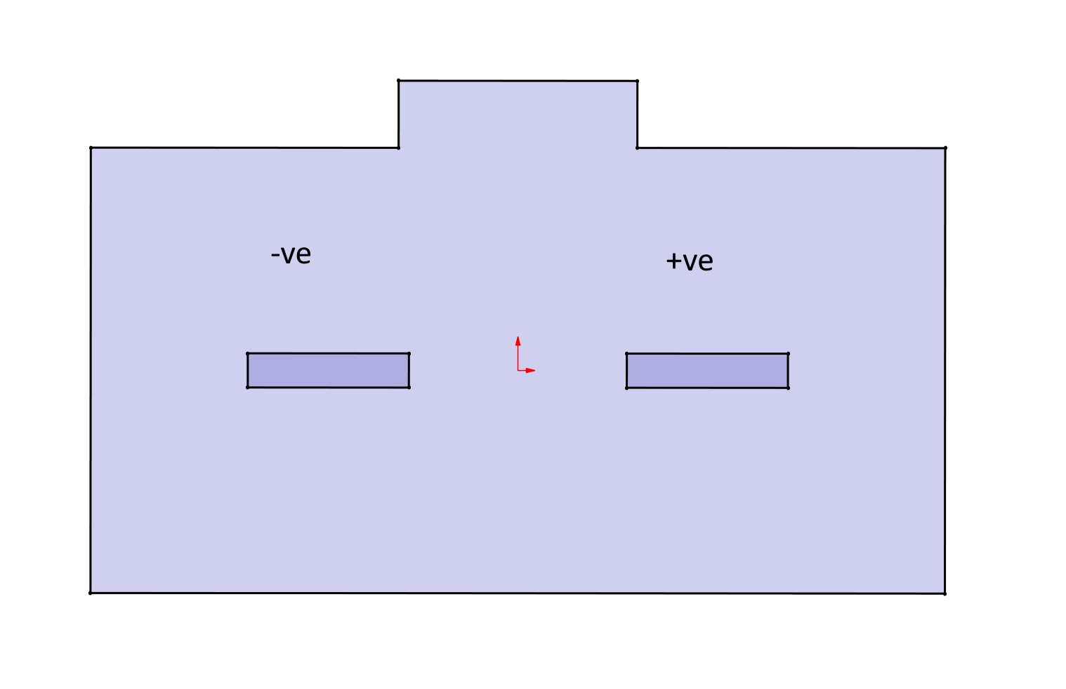

The motor is powered by connector A-03 in the wiring diagram, Applying +12V and an earth to the terminals as shown below will open the valve. Reversing the connections will close it, the valve doesn't need to be and probably shouldn't be powered continuously
I use a Arduino to control the valve on my Stratos. The control logic is roughly as follows.
The ECU (Link) commands the Arduino to open the valve at a set rpm
The Arduino applies power to the DC motor and monitors the pulses from the pulse generator (pins 2 & 4 on connector A-02)
when the pulses stop, turn off power to the motor
Do the same with the polarity reversed to close the valve

AHH interesting so I need to actually open and close it it's not like 12v and it opens and no power and it closes.
Correct.
If you're turbo charged, I'd be inclined to just lock them open, or dismantle the header and remove them, even a small amount of boost will probably override the increase in volumetric efficiency that variable length inlet runners give you
A small confession - I've been driving around with them working in reverse and the car still goes pretty well!
