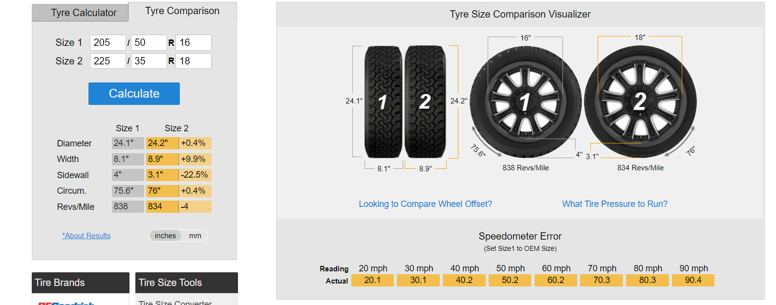

Re: Tires rubbing on spring perch help
A 225/35/18 tyre will bring you closer to the stock overall rolling diameter, giving you a better chance of clearing with a not so large spacer offset.
People often neglect keeping the correct rolling diameter when fitting larger rim/tyre combo's.
