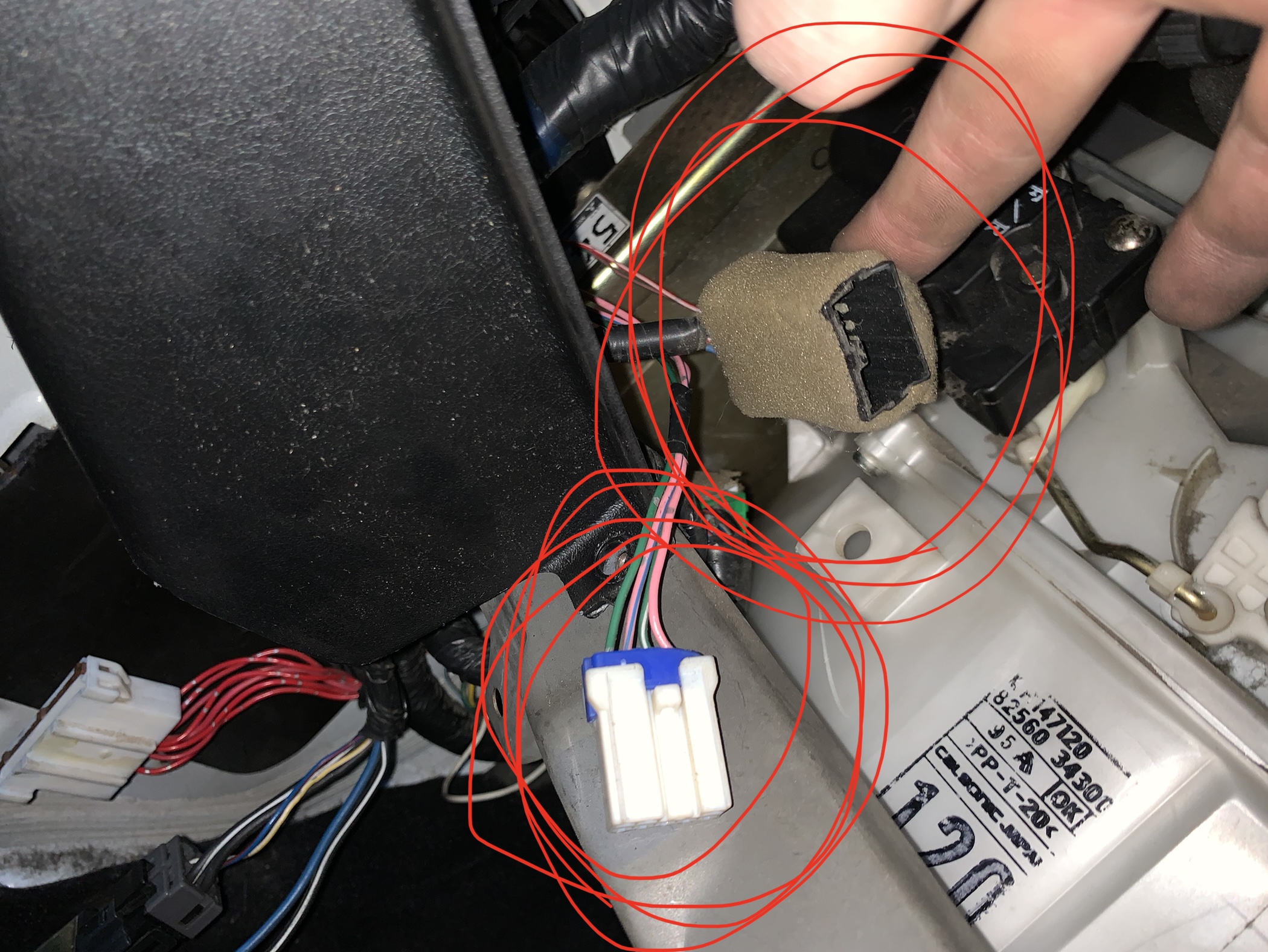

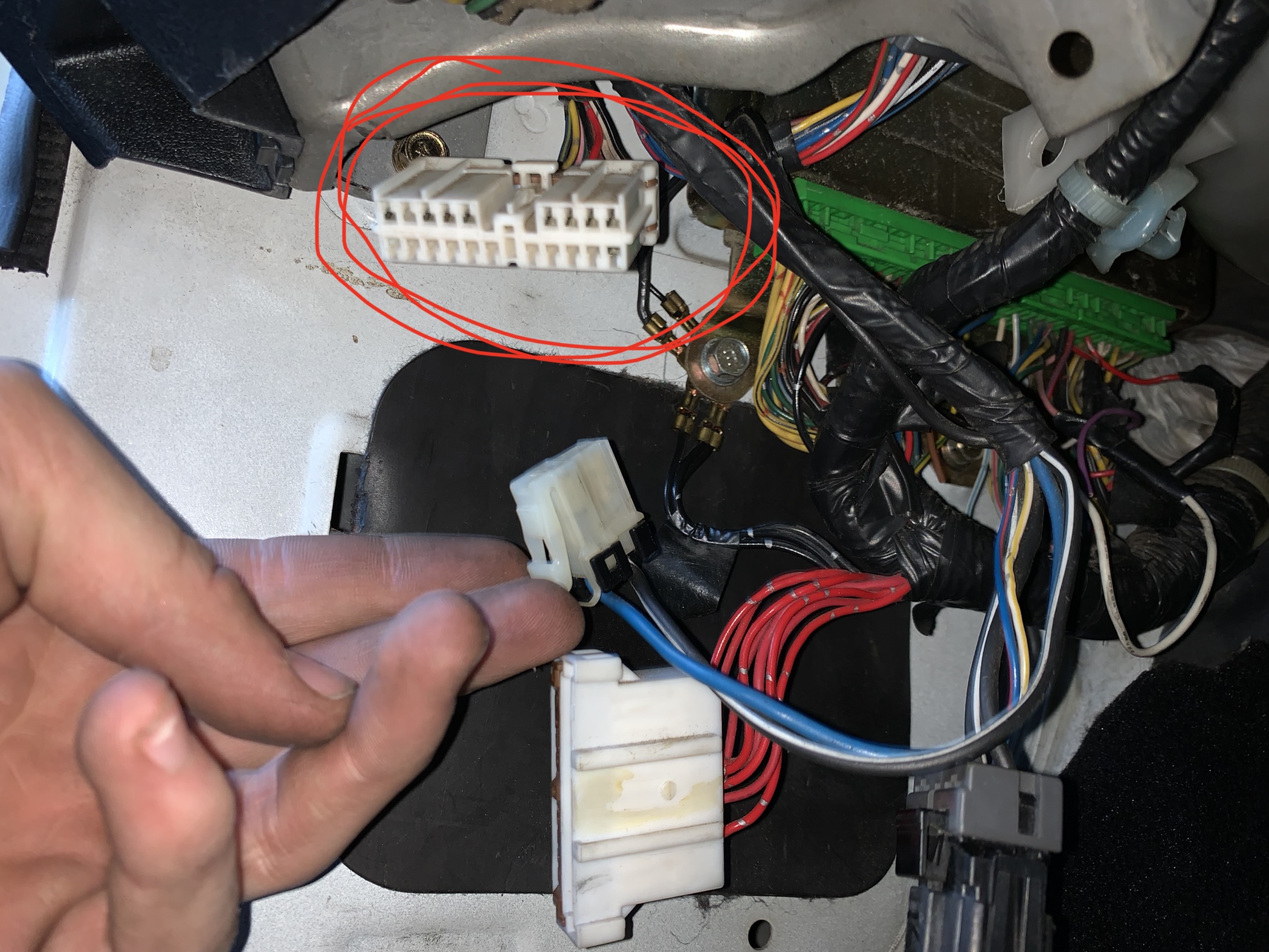

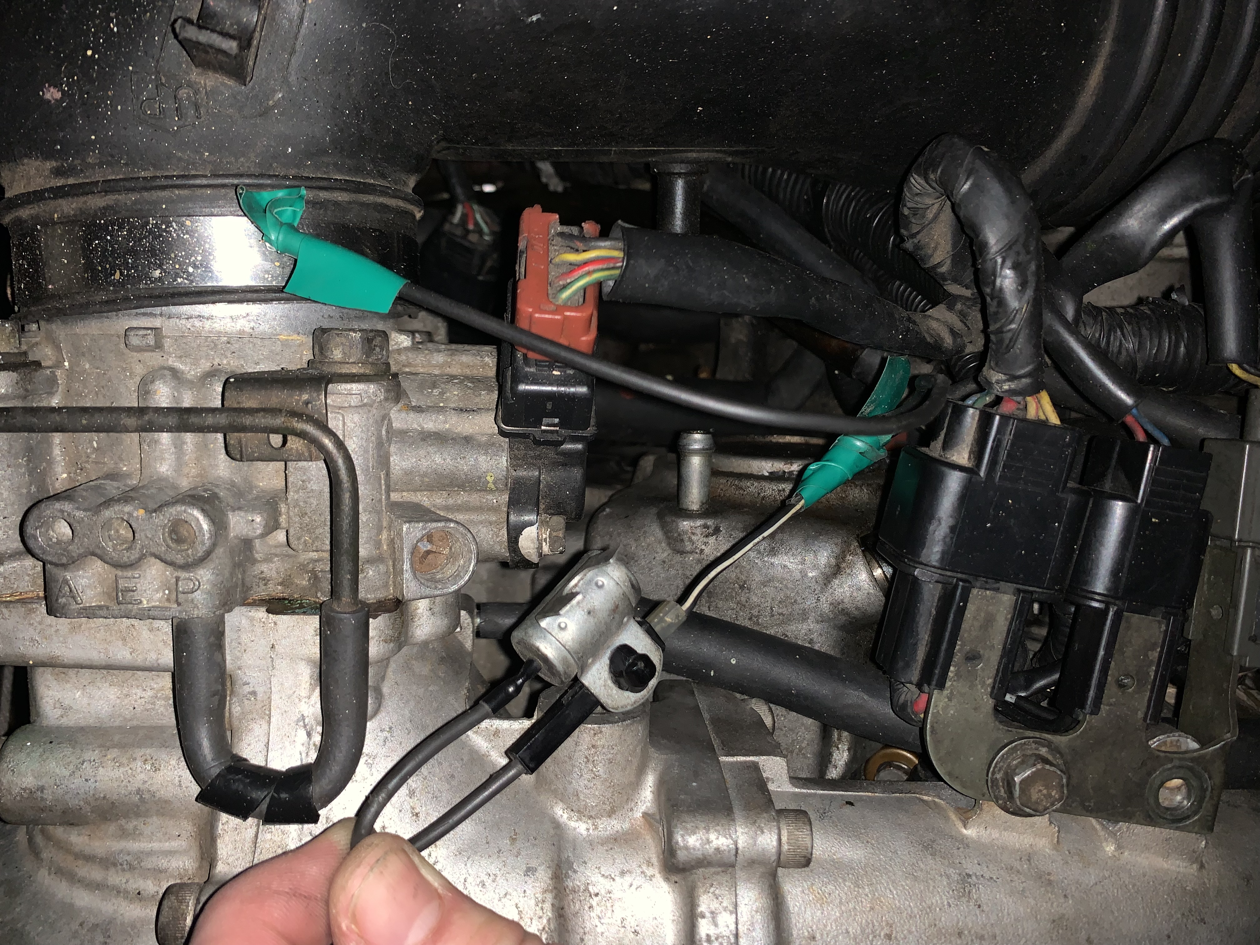

I have recently swapped out the interior wiring loom (ie the one that goes behind the dash and into the ecu and extends to just before the boot), and now the car won't start but just cranks. when re-installing the loom there where 3 plugs which I couldn't remember where they went, included in photos, but i believe to either be unnecessary accessories or something to do with the automatic transmission, these are all on the passenger footwell. Additionally there was other odd wiring jobs done by the previous owners such as a single wire running from an engine component (not sure what called but in photo) to the fuse box (also not sure which fuse cus i forogt to take photos).

Is there any reason why using an auto wiring loom would prevent it from working, I'm assuming its a lack of fuel or spark, not sure as havent tested for either but can't see why it would be anything else, or is there a chance that the previous loom had some bootleg solution that allowed the car to work. Or does the fto have any parts that need to be connected to allow fuel to flow as some kind of safety immobilizer? Or do some of the fuze/relays need to be hooked up to certain locations (currently just screwed into frame just to place them there). Any ideas on what it could be or the unknown plugs would be really apricated. Thank you for reading
