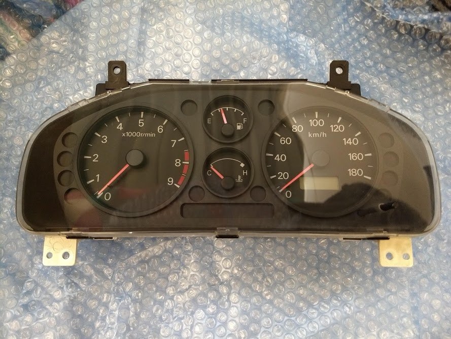

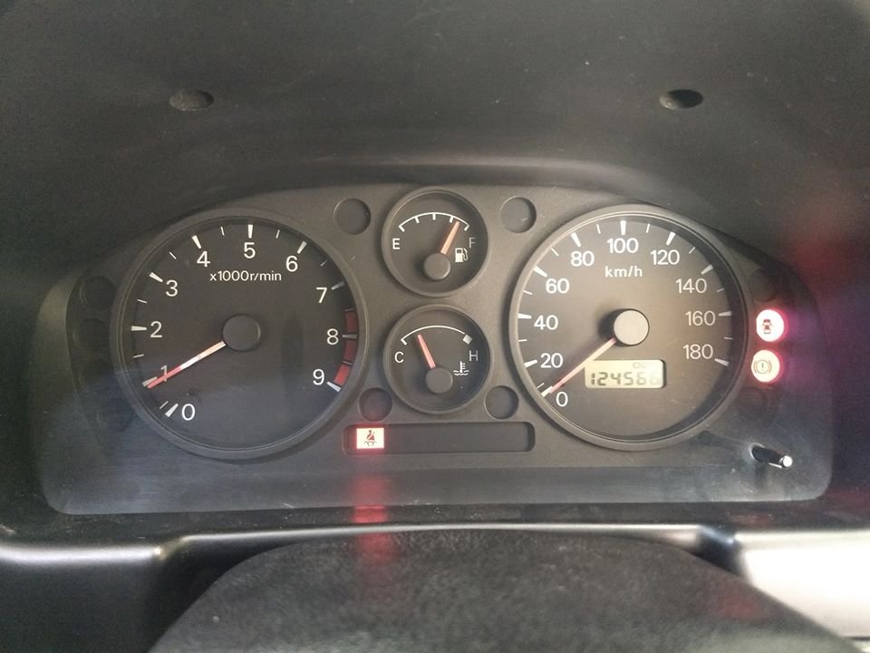

Thanks to Vipfto for shipping me across a GR cluster I've been on the hunt for. So nice to not have blue dash lights (sorry Nick).
Few pics from the other day for good measure while it was clean lol

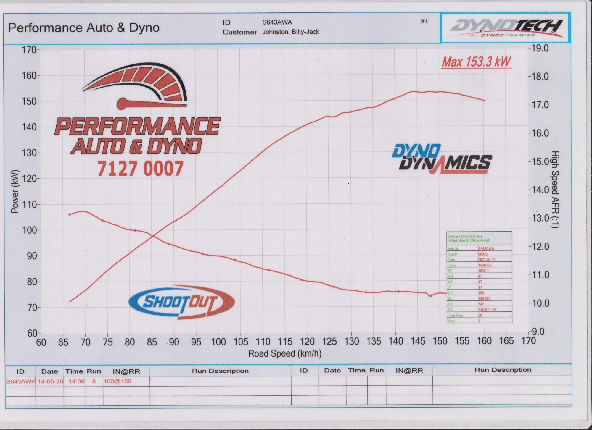

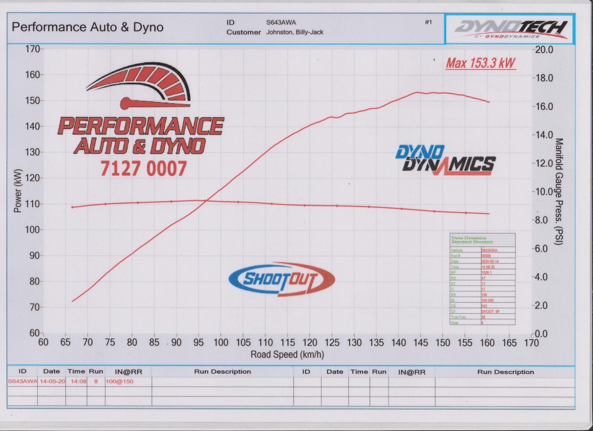

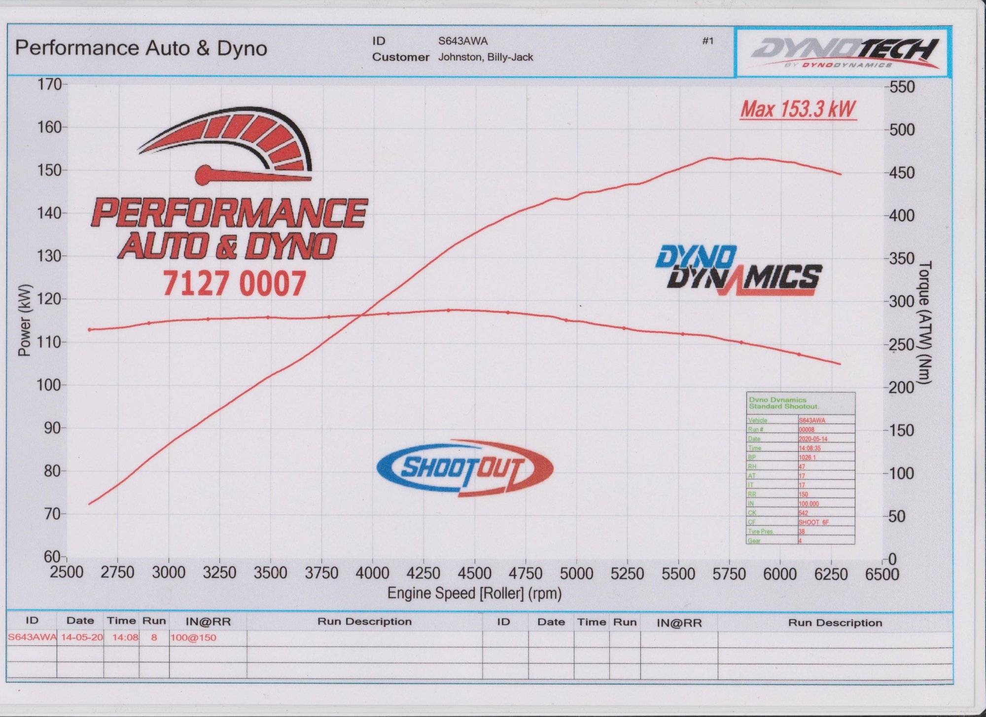

Another day, another dyno... uh, day.
First time for the silver car with this engine, mostly to do another checkup and also see what difference, if any, the Mambatek CHRAs and Kinugawa actuators were going to make on a stock tune. Judging by the results below, I don't think it's going to be noticeable until boost is increased and its reflashed, but there were some small gains.
Compared to the last runs in the white car, boost is up a tiny bit, 0.5-1PSI, spool itself has been reduced, and it gained 5kw from 2750 to 4750 RPM. Peak power is pretty much unchanged.
Did a quick rip through the hills, even followed a nice black 991 GT2RS on the way home (kept up with a 911 *cough*)
![Image](https://i.imgur.com/7xSFpa7.jpg)
![Image](https://i.imgur.com/XW941P3.jpg)
Vectose is putting together a coil on plug kit and 3-port for me atm, won't need too much else for what I'm chasing.
